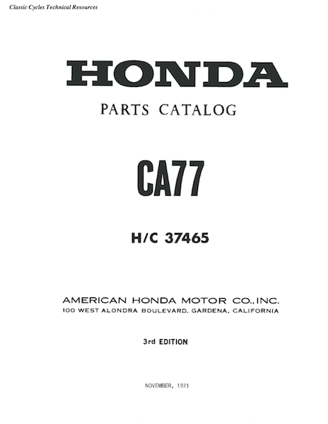

I found one parts manual online, but I'm not sure it's what I need. I'll post a picture of the cover of it. If you have something different I would love to have it, if you don't mind sending it over. I'm on a budget for this bike as is. My email is stark.joseph@gmail.com
- Screen Shot 2017-06-19 at 12.32.32 PM.png (54.78 KiB) Viewed 2812 times
