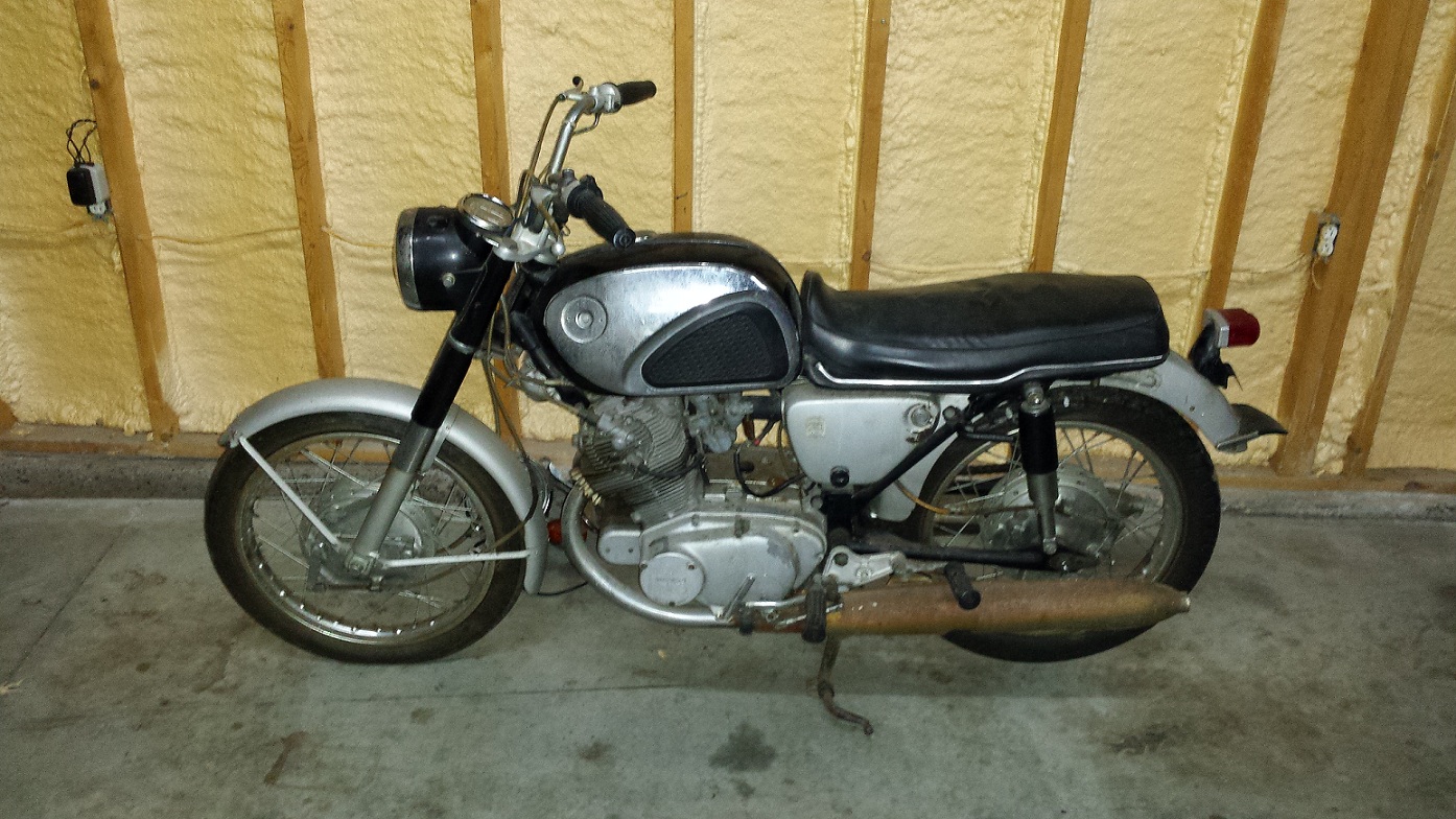

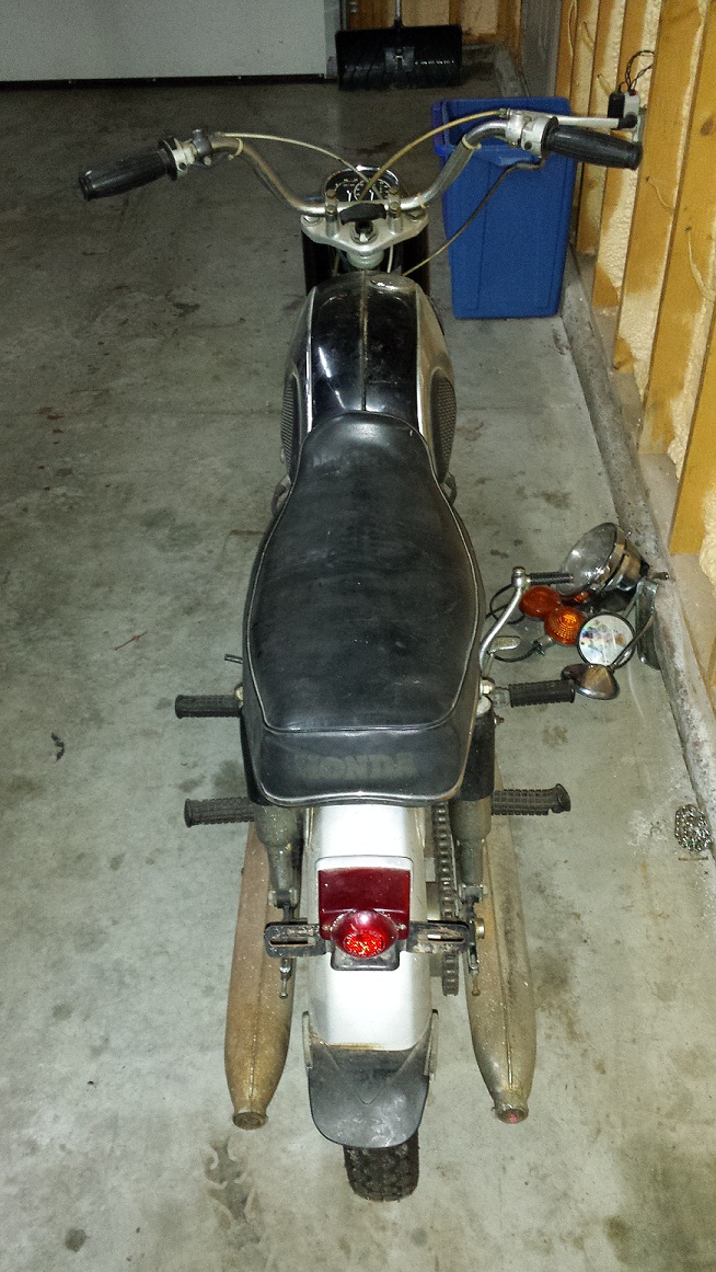

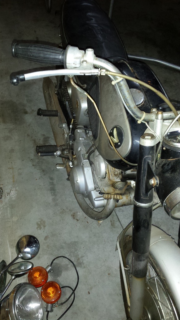

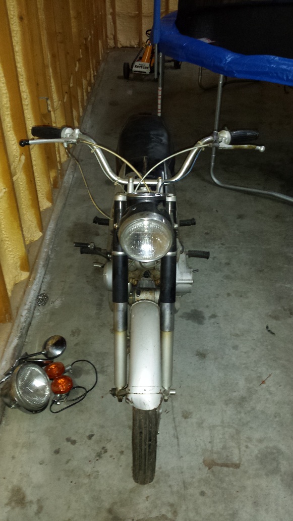

Post by Merz64cb77 » Sat May 13, 2017 6:44 pm
I finally found some time to add some pictures for you all to see sorry for the delay.
