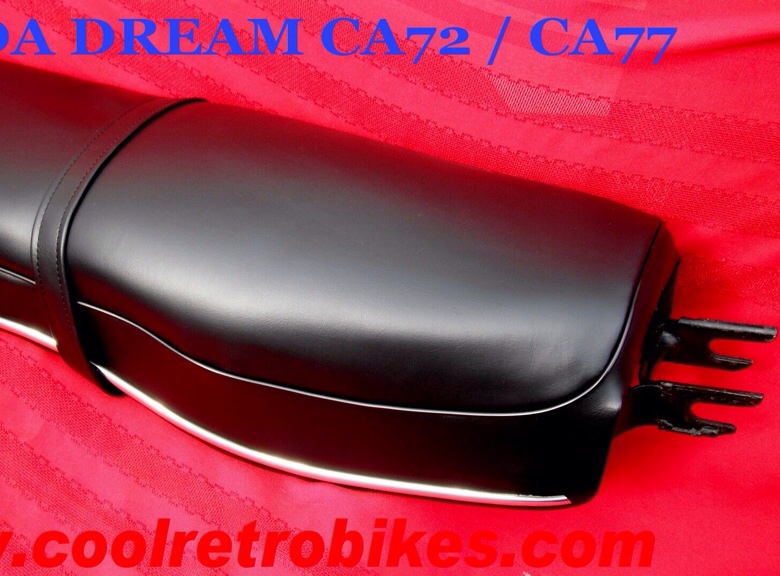

Post by casamere » Tue Apr 11, 2017 6:21 am
Hi John,
As you say it seems as if you are trying to put an early seat with a late tank. This is the seat that fits my 66 Dream. If your seat is round at the front and not forks that fix either side of two nuts then you have thee early seat.

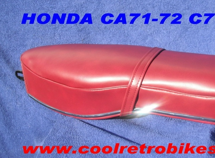

Post by casamere » Tue Apr 11, 2017 6:25 am
This is the early seat that fits the more rounded tank, A few photos would be good.
