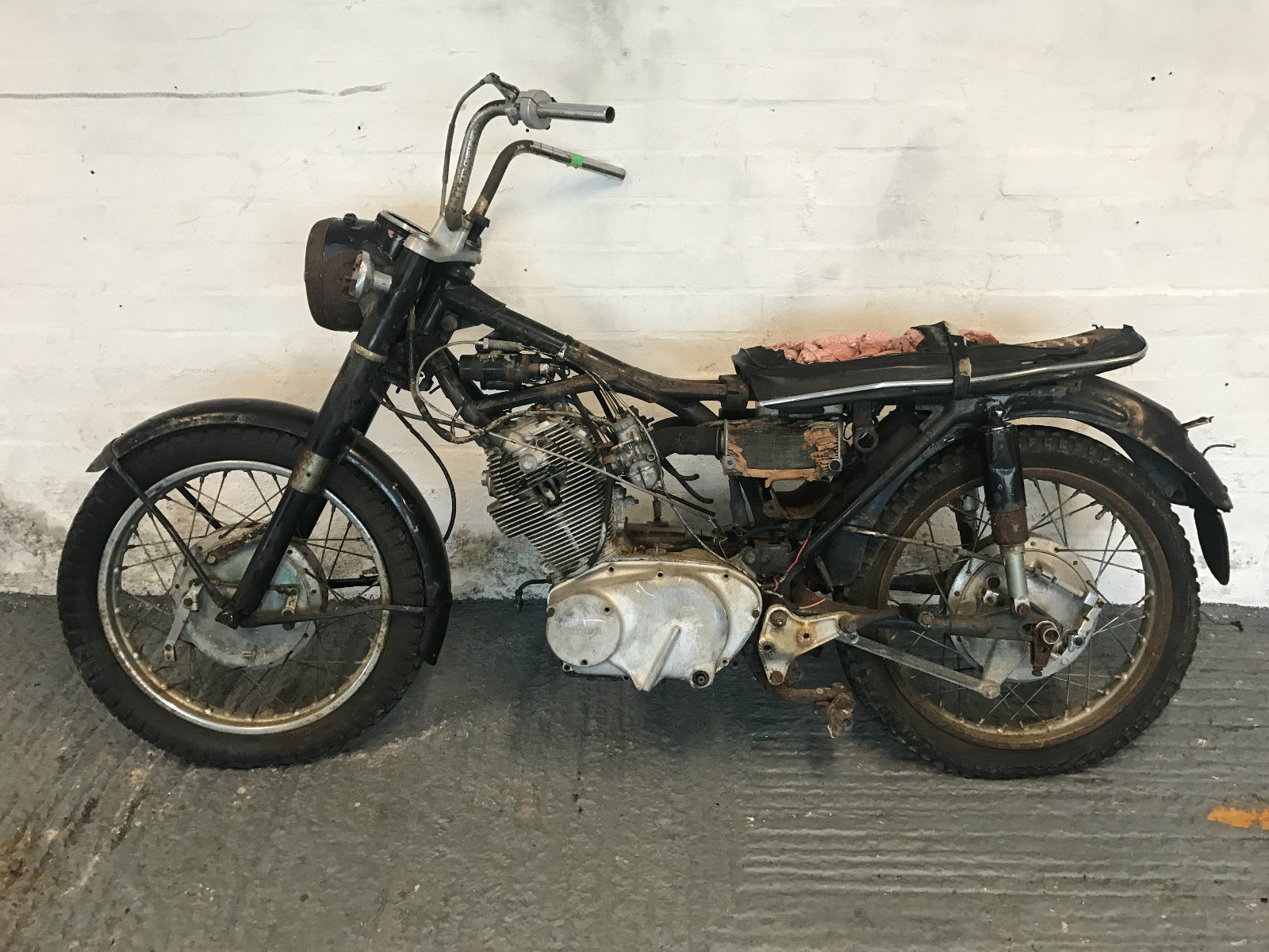

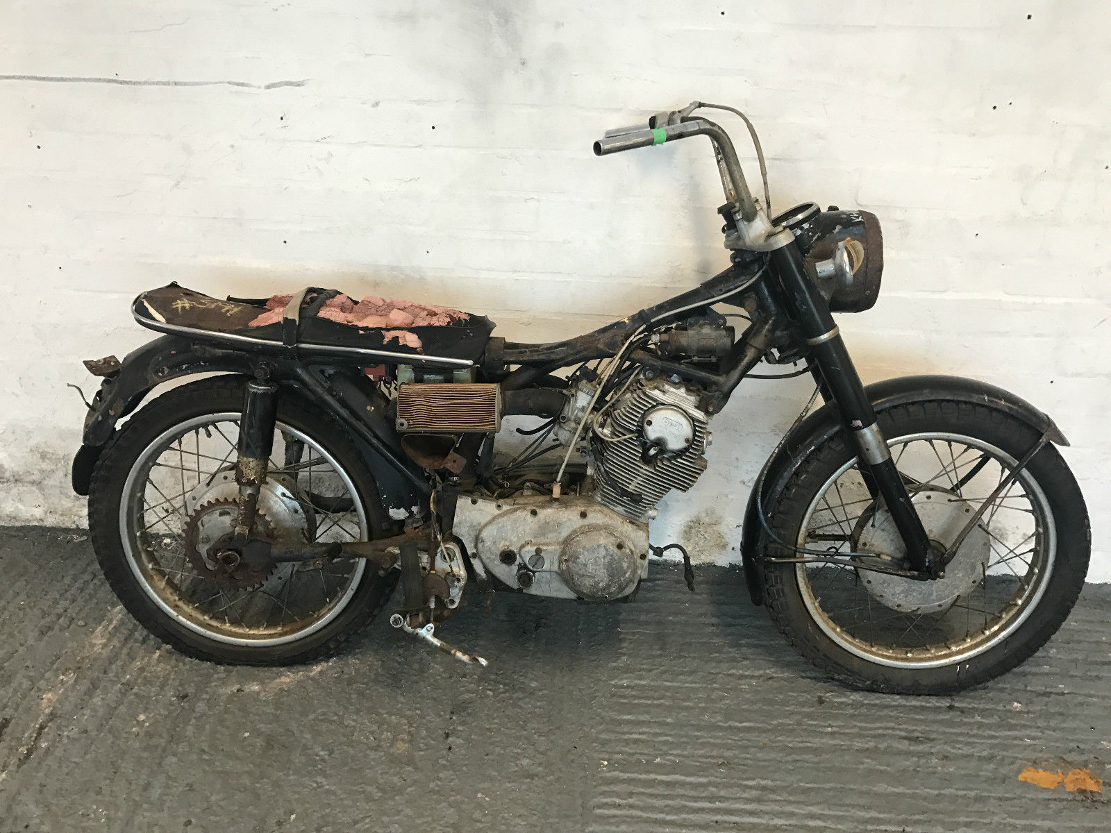

I'm new to CB77's and the 305 engine but not new to bikes. I've had bad bikes all my adult life and know my way around a garage. I've just about completed a nut and bolt restoration of a CB750 (1976) and wanted to go even more old school for my next project. I got the chance to get a rough CB77 and took it.
The bike is bad. I broke all my own rules about buying a project bike. Don't buy it sight unseen (eBay) and with unknown history.. Don't buy a bike with lots of original (expensive) parts missing. Generally speaking, don't be on eBay if there is nothing you really need!
I will post a couple of pics so you can see how silly I have been ...

The frame and swing arm look a little rough in places but are solid with no rot. Front forks are straight. Wheels a little rough but usable. All the rubber is ruined of course. The front fender could be straightened up and used if need be. Carbs look fine but will of course require a full clean and rebuild kit. That's about as much good as I can say for the moment!

Looks like you have a good project there. Not too much missing and you have the unmolested front fender which is good. Take a careful look at your kickstart cover - they are prone to cracking and can be difficult to repair and expensive to buy.
