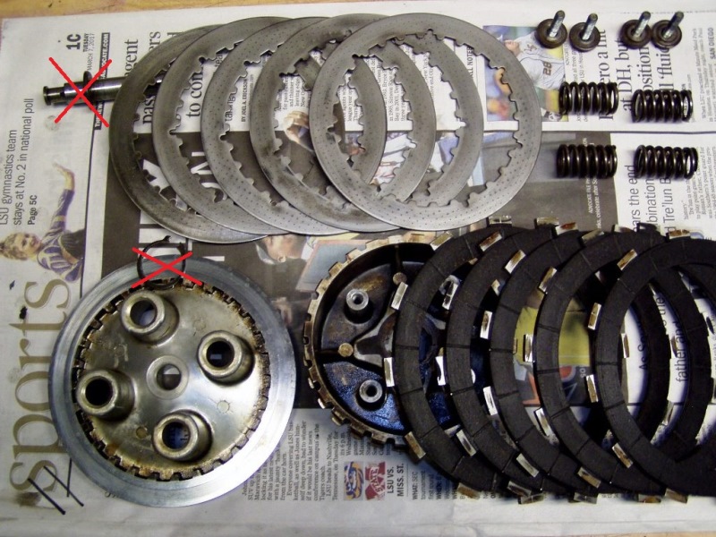

This is a '62 CB72 I bought a little over year ago at a good price as it was partially restored but the owner had acquired other bikes that he wanted to concentrate on. After LOUD MOUSE helped me get the carburetors sorted out, I replaced the ugly (metallic burgundy!) paint job with stock colors and since then I've been riding it a lot. The more I ride the better it runs so it's time to address the clutch that slips at full throttle especially when cold.
First, it appears to have five of the newer (ideal?) “-020” aluminum core friction plates that are in good shape (3.71 – 3.75 mm measured thickness). The steel plates also look good but the “A” plate is the same thickness as the “B” plates (1.6mm) so I’ve ordered a thicker (2.1 mm?) “A” plate (22321-GHB-811) on eBay.
The springs are .115” wire and measure 750” O.D x 1.255” long. I’m thinking these should be replaced but there’s a wide variety of opinions on what springs to use. LOUD MOUSE are you there? What’s your latest recommendation and where can I get them? Other opinions welcome.

ojwilliams1 wrote:This is a '62 CB72 I bought a little over year ago at a good price as it was partially restored but the owner had acquired other bikes that he wanted to concentrate on. After LOUD MOUSE helped me get the carburetors sorted out, I replaced the ugly (metallic burgundy!) paint job with stock colors and since then I've been riding it a lot. The more I ride the better it runs so it's time to address the clutch that slips at full throttle especially when cold.

It's hard to be sure from your picture but some of the steel plates look to have 'hot' sections on them which suggests that they may not be dead flat, an essential for a good clutch.
When assembled the plates need to be so flat that the oil sticks them all together to the point where they have to be pulled apart, anything less isn't really good enough.
LM helped me to sort mine out, hopefully he will do the same for you.

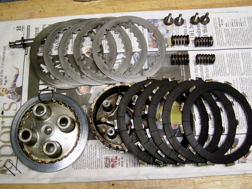

Called LM and as with many before me he solved my clutch problem with advice and parts recommendations. I still have the old clutch parts shown in the original post. I hate to just throw these parts away but I'm not a pack rat so I don't want to just keep them around. I'd be willing to send to anyone who wants them for shipping cost (except the snap ring and and lifter piece/oil guide parts) . It would fit in a medium USPS flat rate box for $13.60 shipping. If you're interested give me your zip code and I will try to ship for less.

I'd like all the disc and spring/bolt parts.
