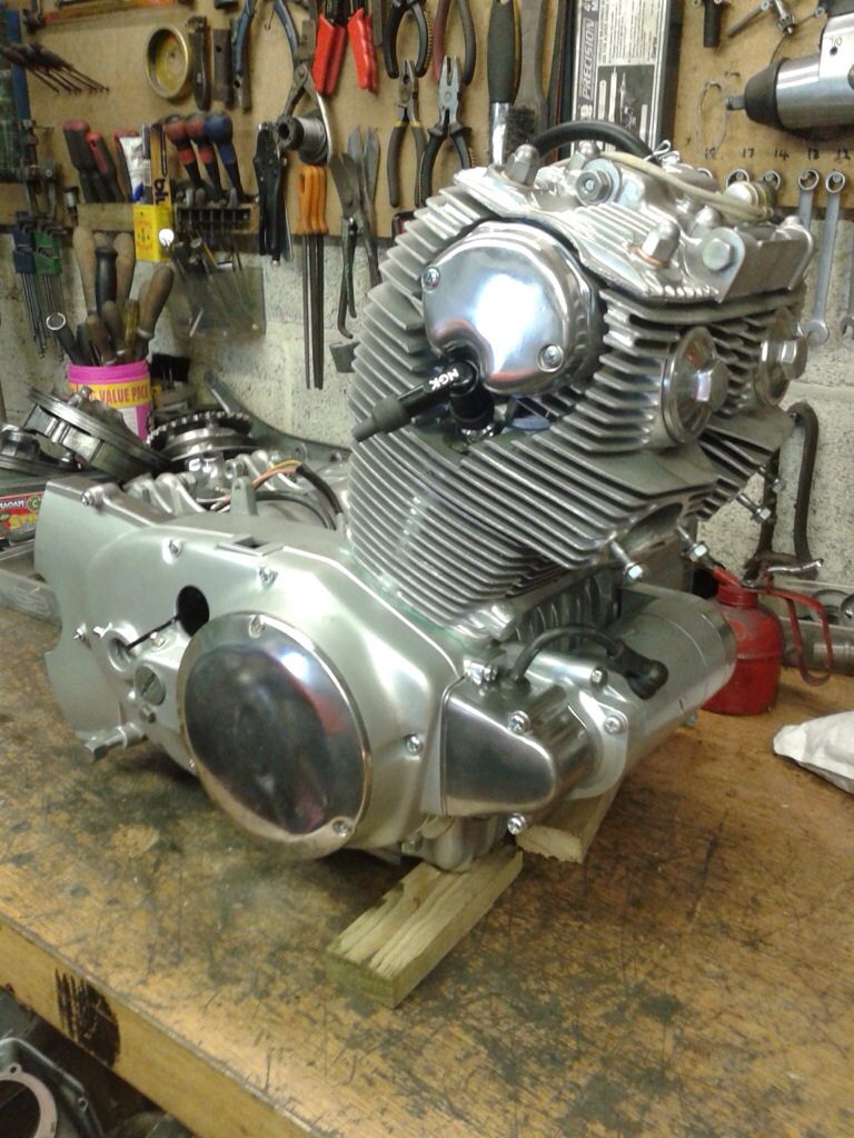

Post by casamere » Fri Dec 09, 2016 2:25 pm
Valves ok as engine was rebuilt 18 months ago but have a new set of timing springs to go in. Will check carb while engine is out.
