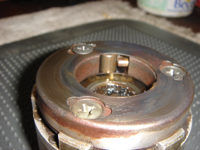

Yes the starter clutch is behind the rotor. Make sure the Philips screws are tight, and the rollers, pins and springs are clean and move freely.
DREAM CA77 013.jpg (42.04 KiB) Viewed 5489 times
