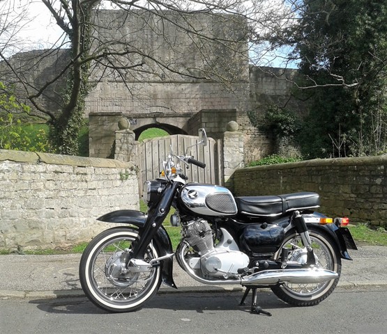

You have a nice project there and it all depends how far you want to go. I wanted my CA77 as near original as I could get. As for the paint I have seen some beautiful colors on here although not original it all depends on your choice.
20160413_143850 - Copy.jpg (91.35 KiB) Viewed 2221 times
