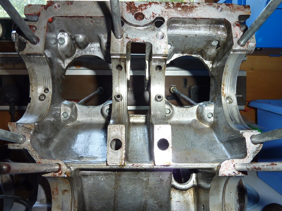

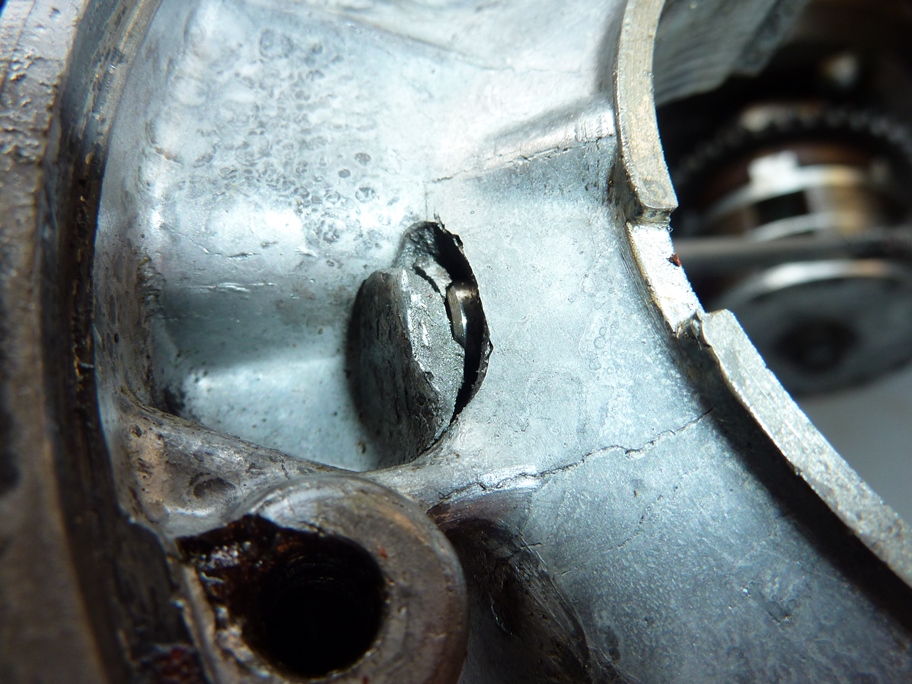

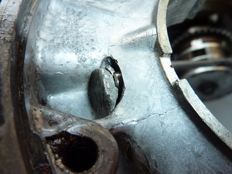

An inherited "project" continues to provide surprises. This time it is the crank case. The knock pin appears to have been forced into the crank case and pushed out through the aluminium. Any one any ideas why this would have occurred and if the damage is likely to be critical once I get the pin out that is.

The outer race of the crank bearing wasn't indexed so the hole matched the pin location.
Then the cases were put together.
Tap the pin BACK INTO the hole just enough to allow the lose piece to be J.B. Welded in place.
Add a little to the area around where the piece came loose. ....................lm

Many thanks. J B Weld and Q Bond are worth their weight in - well metal!

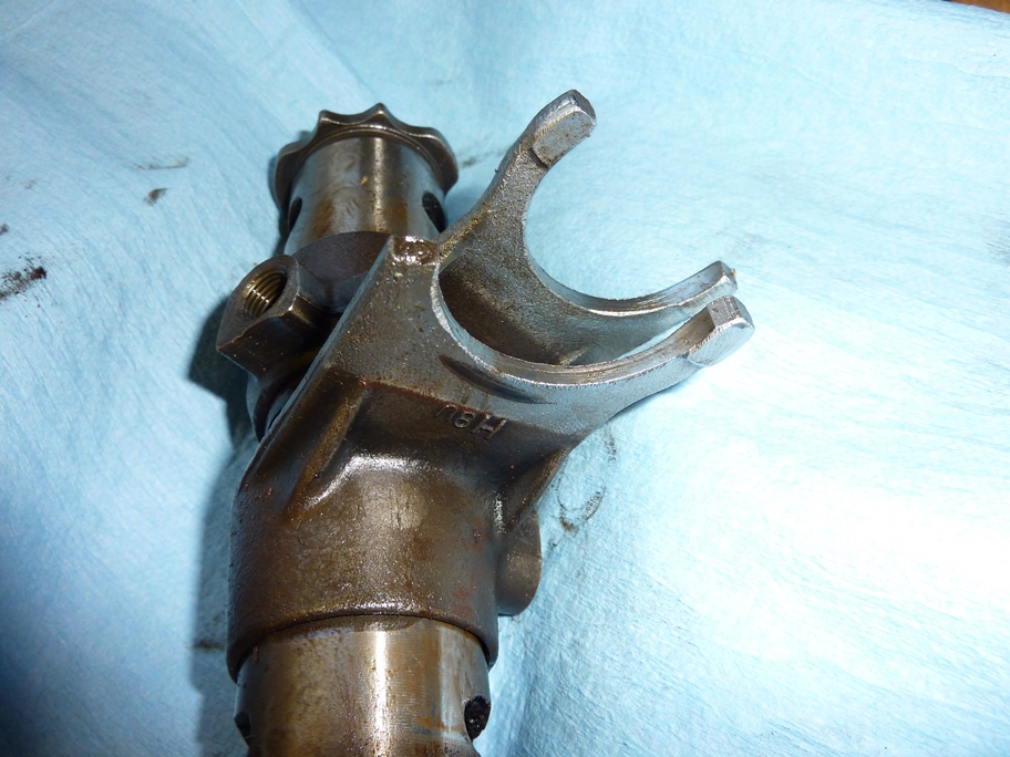

Now does any one know if, or where or how I can repair a gear fork?
The list keeps on growing :-)

Re: Pin problems
You replace it.
I have good used ones. ...............lm
