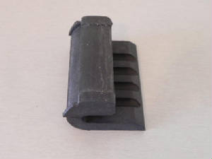

I have a late model CL77. I don't know what is missing from the front of the seat. Is there a rubber piece missing? Just metal seat pan kind of hooks loosely under a square box on the frame.

A molded rubber sort of sleeve fits the seat/frame. ..........lm

Honda part #77101-273-300P
Although you might find it elsewhere for less $, you can find a new reproduction part here: http://www.claussstudios.com/id45.html

Thanks for your help. Photo, part no. and source. Very helpful.
