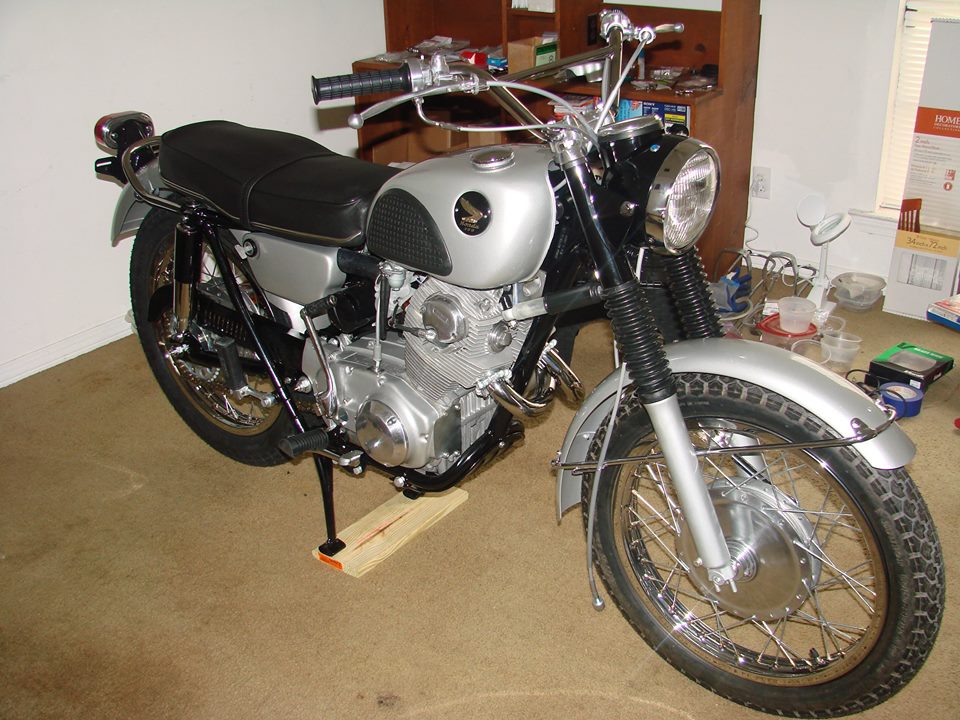

The look while not being the exact tread as original is close and fitment to fender is correct. Some like the look of the full fender space with the 3.25x19 while I prefer the closer to original look the 3.00x19 gives. Looks good either way, just passing info along that the size can be had in the K70.

Post by bamacl » Tue Jul 19, 2016 9:33 pm
The look
