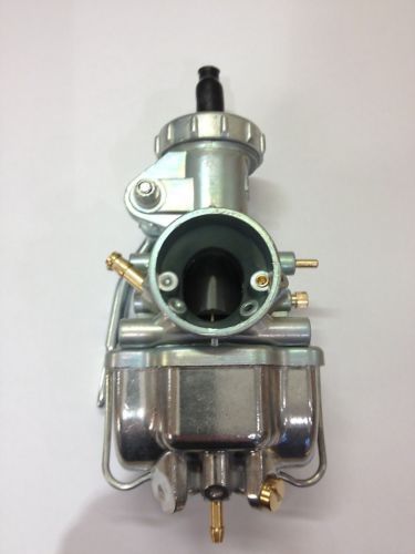

Because my Throttle becomes more and more sticky I was searching on eBay for a replacement.
I found this new carb. you can find the item for searching for
COTTON PW22 CARB TLR200 TLR250 TIGER CUB TWINSHOCK TRIALS BIKE PRE 65
Does anyone has experience with a carb like this?
Thanks for helping!

I can't find a pic of the mounts.
This is how I save carb bodies.
May I offer you cut some 320 sandpaper 1 inch wide/fold in half.
Before removing the slide twist the throttle several times to make the high spots in the barrel shiny.
Remove slide and using your finger move the sandpaper in and out of the barrel.
Use the slide to see any high spots until all are gone. .....................lm

Thank you Ed, my thoughts where that a pw22 carb is a pw22 carb.... In the mean time I know better, there are many different types! Thank you for your advise, I will try and let you know the result.

Just to let you know, works like a charm
Thank for the advise!
