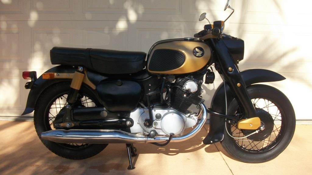

It has been a while since I posted here, but I have been lurking in the background. I've got a problem that has just about beaten me and I'd really love some help if you can assist please.
I have a pretty good condition '64 C72 that I've rebuilt and has been running just fine up until recently. Since the rebuild some time ago, I've been riding around the local streets with the bike running very well and pulling great for a little 250. The old girl has pretty open “Overlander” mufflers and a conical pod air filter - things to make the engine run lean. Admittedly the bike did sit around for a while - maybe 6 months, without being started while I worked on another project.

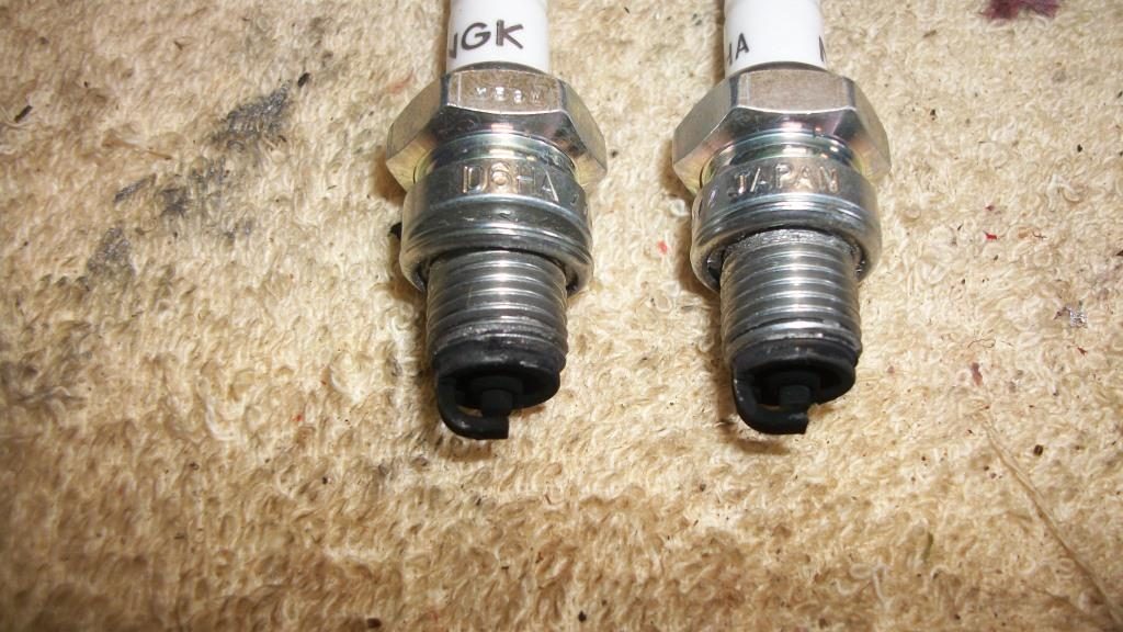

It has been over a year and I've continued to have problems with continual dry black sooty plugs. Even after a couple of minutes in the shed, the plugs were black and heavily coated with carbon. I've had the carb in and out a myriad of times, adjusting the float level lower and lower, but without success. Compounding this, there is not much info around on the Mikuni VM carb.
Because it looks to be running rich, I've dropped the float level in the bowl several times and also lowered the needle into the jet. I've had the float sitting in only a couple of millimetres of fuel in the bowl, but still the plugs carbon up. I’ve taken off the after-market, pod-style air filter, hoping that it may be undersized or restrictive, causing the problem.
I was misled by false hope at one stage, with the float very low in the bowl and a quick belt around the street for 15 minutes looking very promising. Pulled the plugs and all looked very good - nice and tan. However, next weekend when I started and ran it again, back came the sooty plugs.
I checked the floats for leaks, but they seemed good. I checked the needle (float valve) and seat and again, they looked fine. I checked the needle and seat by blowing into the fuel line, sure enough the needle (float valve) seated very well and shut off the flow.
I checked with loudmouse who was a great help and walked me thru ensuring the valve and ignition timing were correct. In loudmouse’s words, the carb is often blamed when really the problem is with timing. But still, black sooty plugs.
In the end, I bit the bullet and ordered another Mikuni carb from eBay in the USA, convinced the carb was the problem. The carb was stripped and cleaned when it arrived. I reassembled the carb, checked the float height to 26 mm, believing this to be correct.
Well, what do you know, the old girl seems to run fine. I’ve been around the local streets for a couple of 10 mile runs with no problems. The plugs look nice and tan.
So what have I missed with the original carb? The needle looks fine; the needle jet looks fine; float looks fine, float valve and seat look good; air filter is removed – why is it running rich?
I do plan to try and compare the 2 carbs and check jet sizes to try and establish what is wrong.
Any suggestions to what I may have missed would be greatly appreciated.
