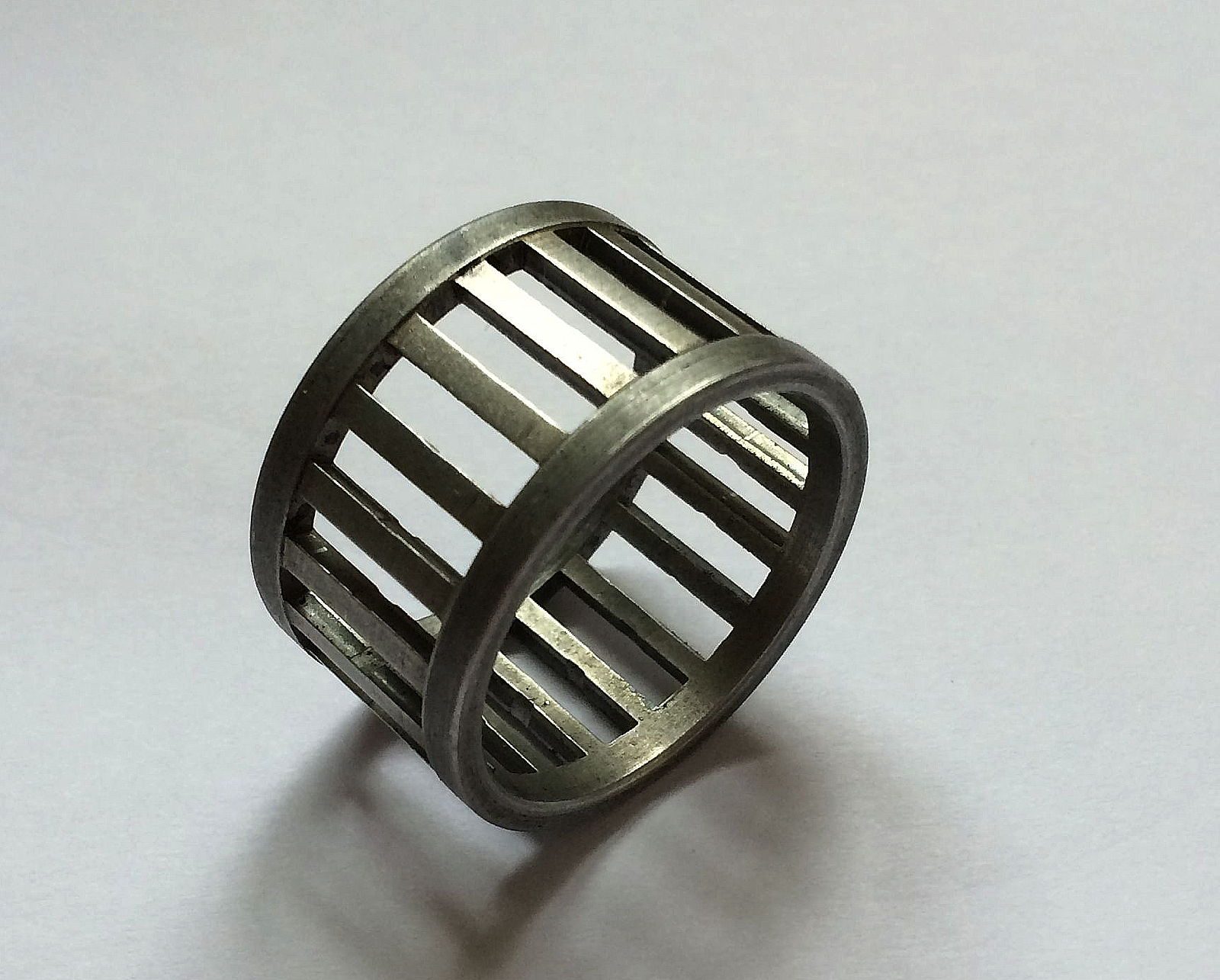

I had some very interesting discussions with Jerry Kooistra who created some of the most successful of CB72-based racers. I think that his 350 and 500 bikes used a combination of CB72, CB350 and CB450 cranks. Not sure about the 250.
I have some of those Yamaha caged-roller bearing and was going to use them in a C72 build. I'm wondering if the 'difference' for the race guys is that the Yamaha cage has seperate rollers where the 'standard' Honda cage has them running in pairs. I know that the double roller design causes rubbing between the rollers and consequent overheating and failure at high speed.
There is a single roller cage that will fit a 26mm pin available from Rex Caunt here in the UK but it is a little narrower than the Honda big end and would nee a couple of thrust washers making.
Also, I think that Cappellini make a single roller cage for the CB72 which is similar to the original Honda 'racekit' design.
