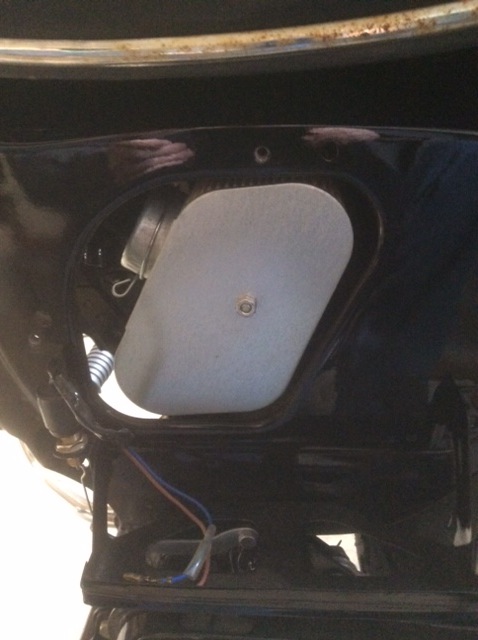

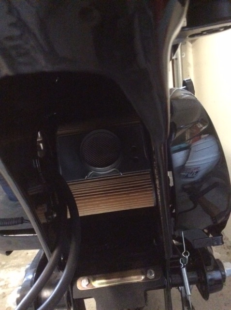

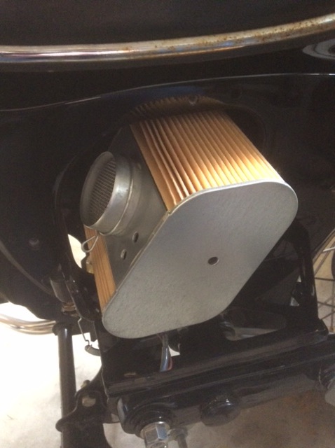

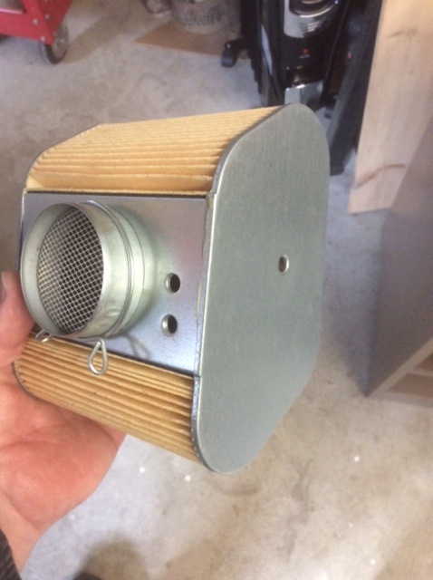

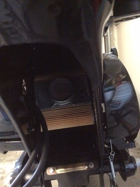

Here are some photos:
Installed; view from engine back toward rear of bike (engine not installed).
Installed; view from left side of bike.
Inserting the air filter.
Air cleaner.
Air cleaner.

Most helpful. Thank you.

That's the same air cleaner as on my '67 Dream. I HATE that arrangement!!!!!!! Try getting that damned air hose on between the filter and the carb! Honda would have gone out of business if they had kept on with those stupid designs!
