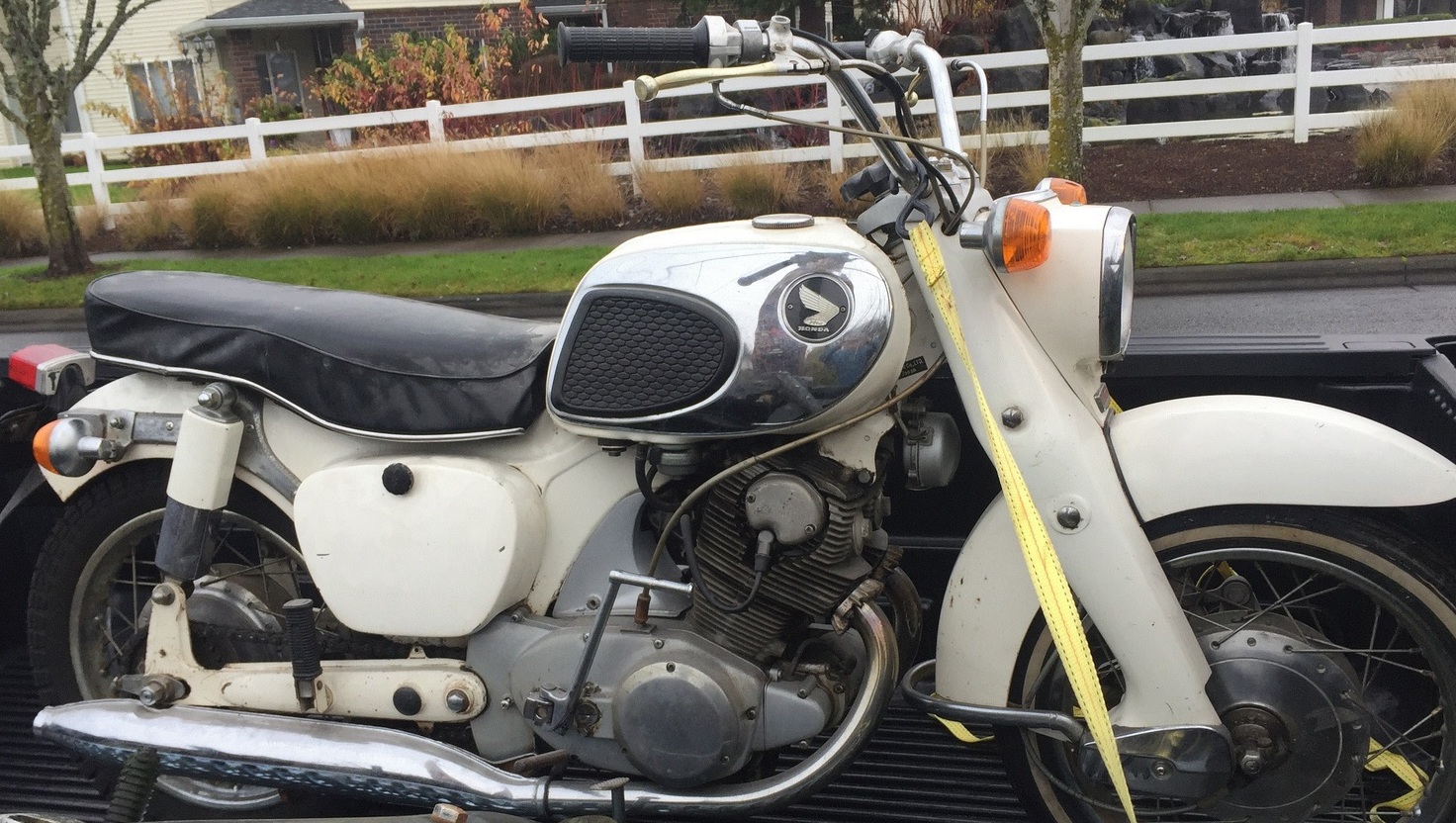

Hi all. I now have a 67 Dream 305. It needs to be put back on the road but it is complete.
Thinking in terms of performance improvements for a daily drive type use, I have looked at the big bore kit. I'm also quite curious to learn more about using a 250 head to create quench. If anyone can direct me to a web site that might describe this modification, I'd appreciate that.

Post by Nick » Fri Dec 16, 2016 2:11 pm
Looks like you found a nice one!
Having used a Dream for daily transport for many years (rode it to work again just last week) on both surface streets and the highway, I would not suggest going to a big-bore kit. In stock form the Dream is under-carbureted, under-geared and the mufflers are overly restrictive. You'll enjoy significant performance and speed increases if you go to a slightly larger carb, less restrictive mufflers (I simply pulled the baffles out of mine!) and a 2-tooth smaller drive sprocket.
More gains can be achieved by modifying a Superhawk cam to suit the Dream's 360 crank. A 2-into-1 exhaust will also help.
You needn't be afraid to rev the Dream, they love to rev.
