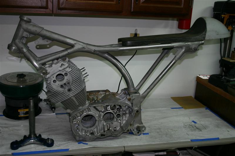

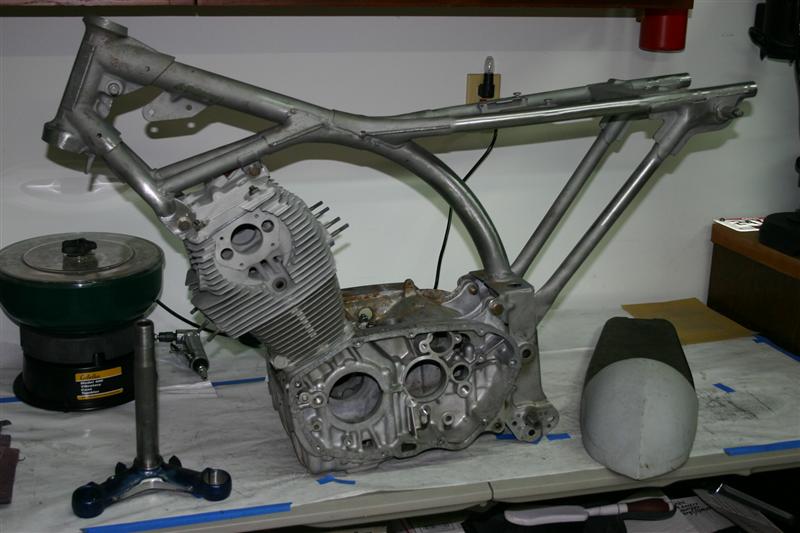

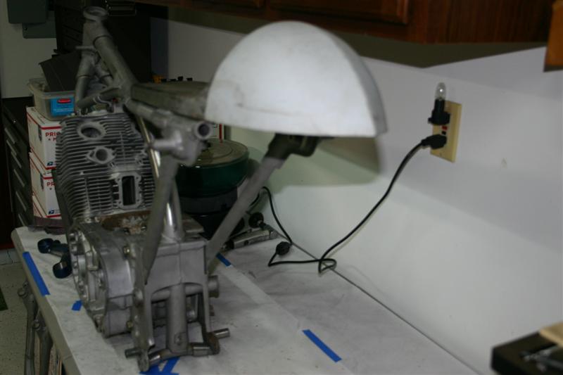

I still have welding to do on my frame, such as mounting points for the tank, seat, a rear loop to join the frame where the stock seat mounts were removed, and two horizontal braces above the motor mount "box". I ordered some 24mm OD x 21mm ID 1018 steel tubing for the braces and loop. I cut off the stock seat mounts, the steering lock [from head stock and lower triple], battery box, stock muffler mnts, ignition bracket. I did a mock up of the bare engine to make sure all motor mount locations were correct [some were distorted from not properly shimming frame to engine], as I don't want any issues after the frame is powder coated.
I have a NOS center stand on the way, as the original was worn out, I'll have to turn up some bushings to repair the frame where the ctr stand bolts were loose and elongated the mntg holes in the frame. I've got new bronze bushings for the swing arm, as well. I'm also cleaning up weld splatter and some pitting on the frame and swing arm. The frame was quite rough and the previous owner had repainted it over the rust, and the battery box was heavily pitted.
