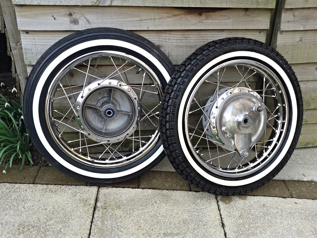

Post by casamere » Thu Jun 09, 2016 3:19 am
I have used a 3.00x16 on the front of my CA78 and it rides fine.
