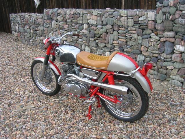

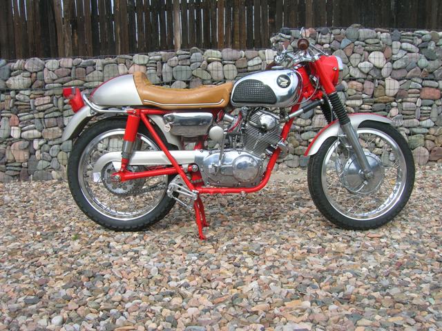

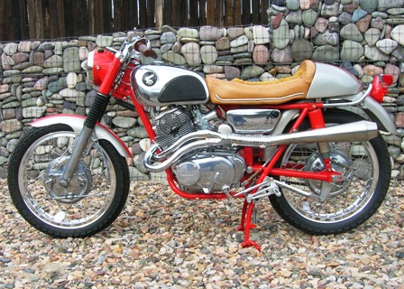

Wanted to share my 8 month work of art project, the upgrades are Bore-tech 358 kit, RD valve spring kit, Amal 626-301 Concentric with chokes, Charlie's Place Ignition, Excel rims and K81 tires- 4.10 rear 3.50 front, European bar's, 2 into 1 exhaust
the custom seat and front fender make this a very nice road burner.
I also have all the original parts to take it back to stock.

Nice, moondogger! Gives me Ideas for my 3rd scrambler

I like it.
For sure the pipe and seat. ................lm
moondoggers wrote:Wanted to share my 8 month work of art project, the upgrades are Bore-tech 358 kit, RD valve spring kit, Amal 626-301 Concentric with chokes, Charlie's Place Ignition, Excel rims and K81 tires- 4.10 rear 3.50 front, European bar's, 2 into 1 exhaust

Thanks for the comments.The idea was to keep the Scrambler style with the tank and pipes , the sound coming out of the 2 into 1 megaphone is like no other Honda. Throttle response from the Amal's is like instant up to 5000 rpm through the gears, I am still breaking it in and looking forward to 9000.
The seat is hand stitched leather with the center leather turned back side out for grip. We bought a scrambler seat pan using it for the base to mount the fabricated fiberglass rear portion and a custom release latch mechanism.

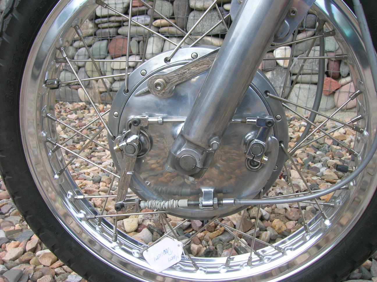

Post by moondoggers » Wed Jan 06, 2016 9:51 am

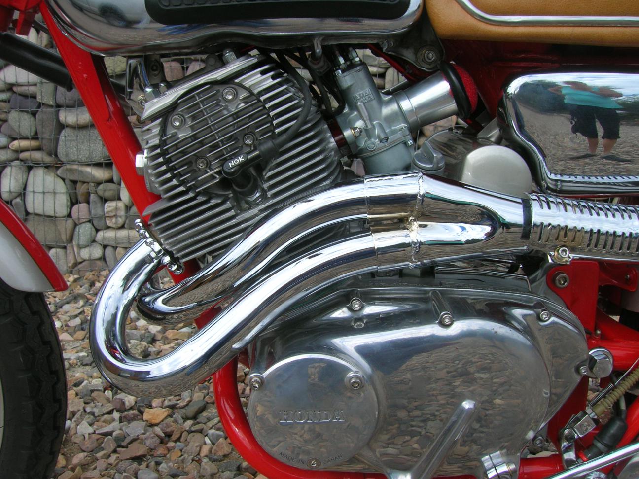

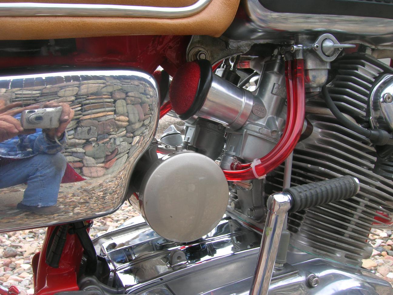

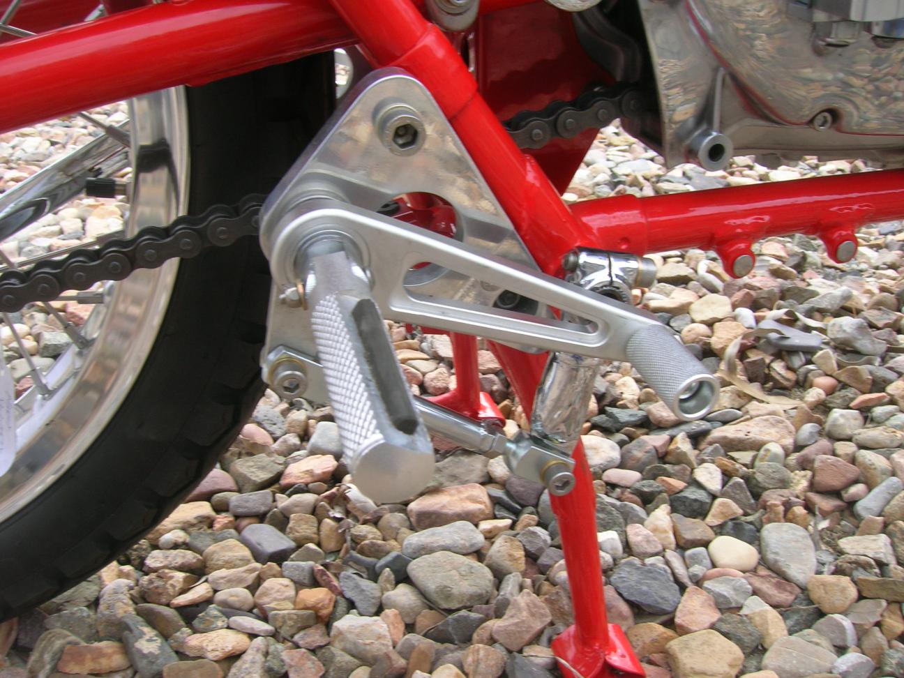

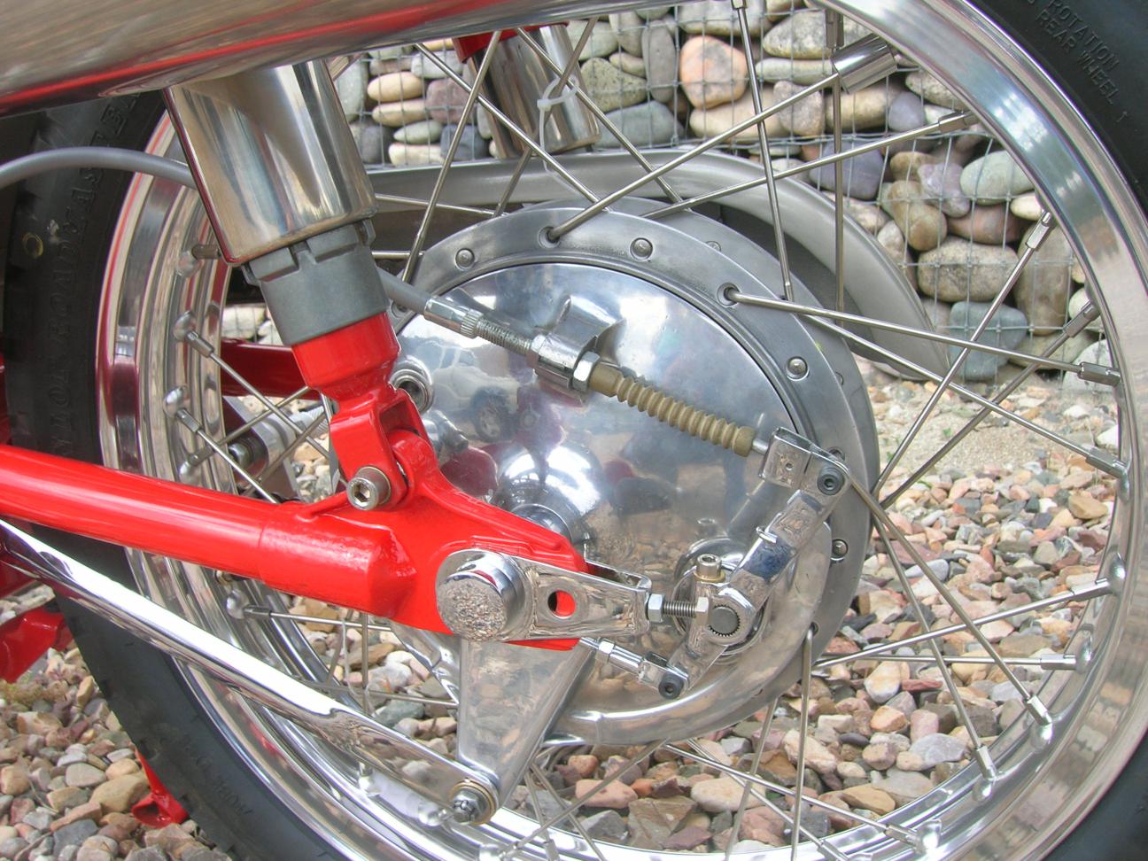

Here are the up-close pictures
close-up pics
close-up pics
moondoggers
Posts: 102
Joined: Thu Jul 18, 2013 11:53 am
Location: Paulden, Arizona

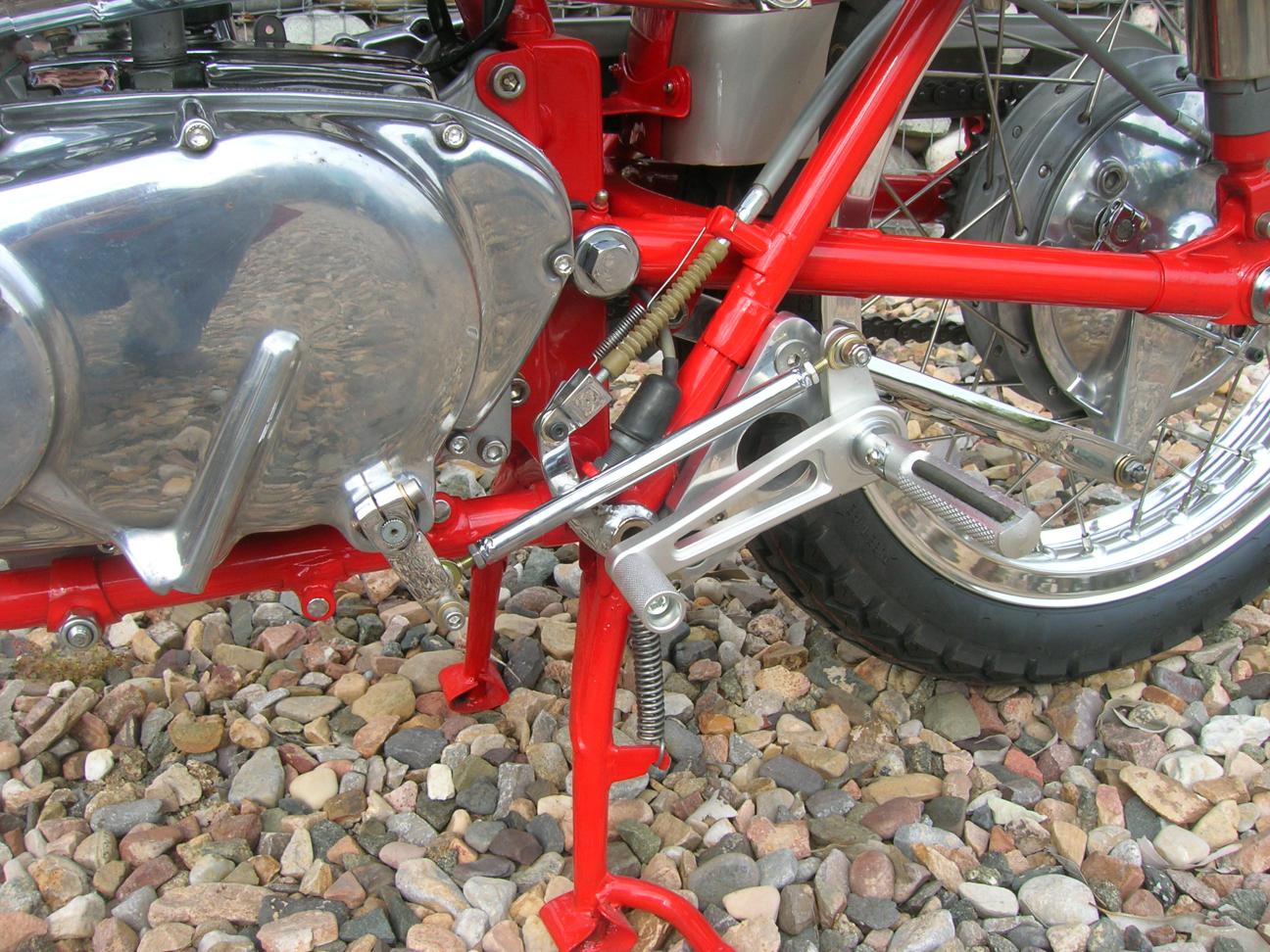

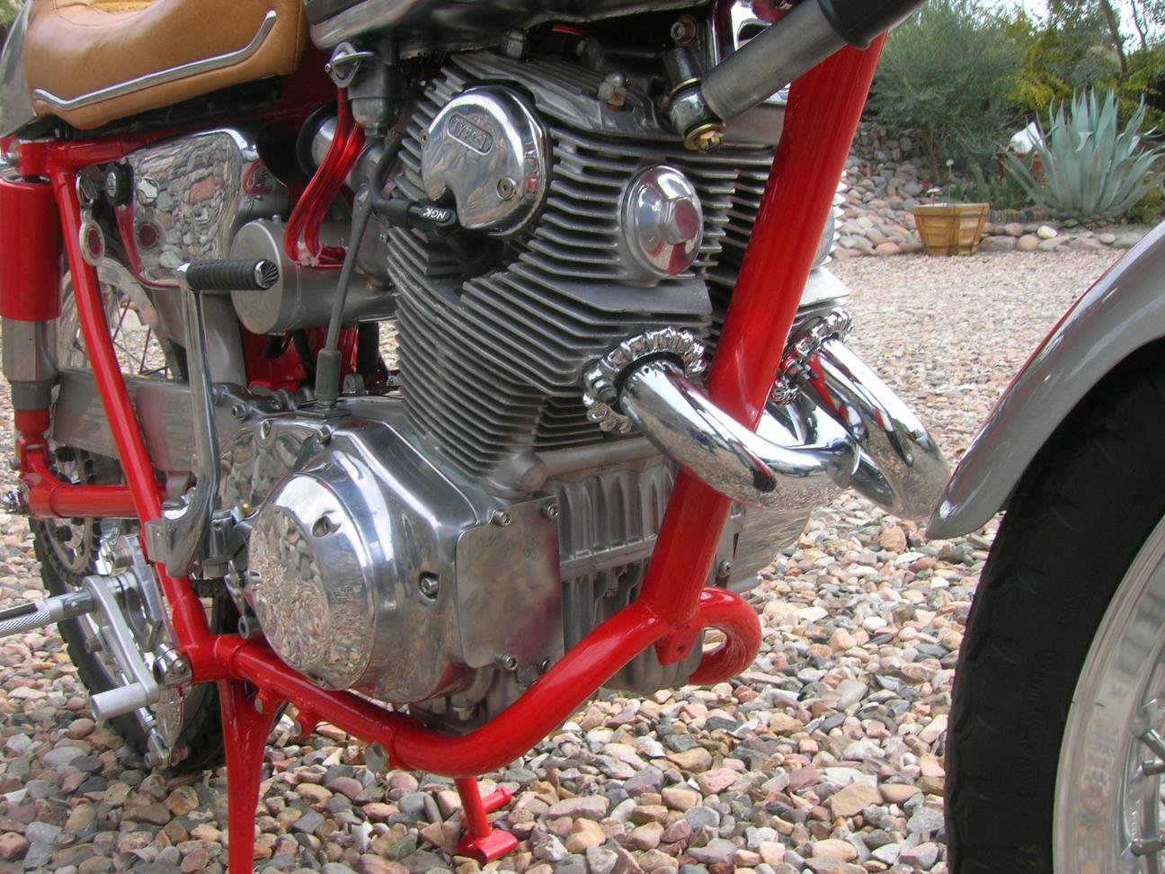

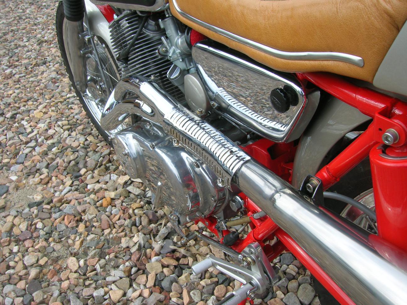

Post by moondoggers » Wed Jan 06, 2016 10:02 am

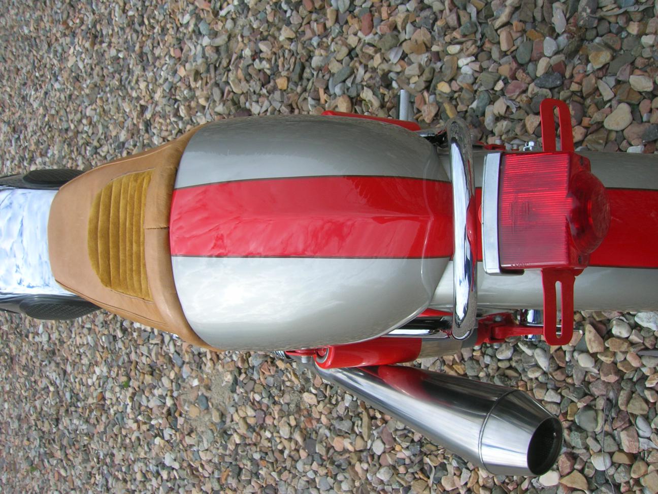

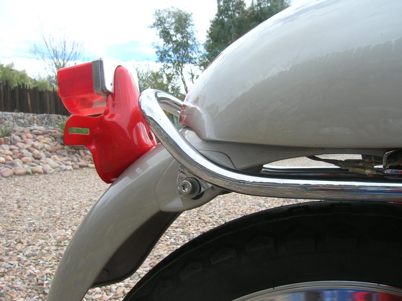

Additional close-ups
close-ups
close-ups
