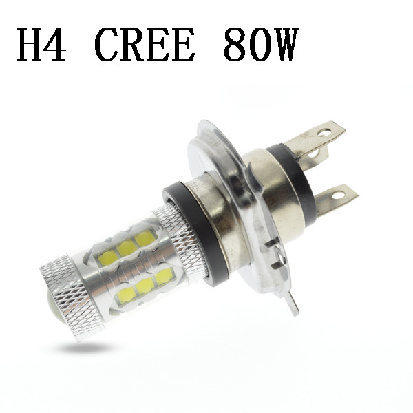

Thanks for the reply, revlover. The specs say 8 watts.
Voltage: 12v AC/DC
Color: white
Led chip: 5w*3pcs cree led in four sides+4pcs cree led in top side=80w(16pcs chip)
Power consumption: 8w
Brightness: 800LM
Liftspan: 65,000 hours
Diameter: 18mm
Low power consumption.
Easy installation, just plug & play.
Light weight, long lasting.
Direct replace old filament bulbs (no wiring)
