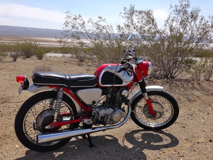

Picture below shows the same bike cooling off after advanced timing melted the right sparkp plug electrode down to the ceramic on the long climb to Randsburg (CA, not SA).
