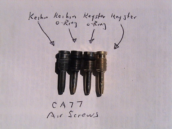

Post by brewsky » Sun Oct 11, 2015 5:48 am
Some carbs had 0-ring screws and some didn't.
The ones that did had a deep groove just under the head, the others just a shallow "groove".
Attached pic shows both types, with the ones shown with no o-rings don't get one.
ca77 carb screw orings.jpg (40.2 KiB) Viewed 5144 times

On the air screw without an O-ring groove, was an O-ring used under the spring, around the round shank?
Post by brewsky » Sun Oct 11, 2015 8:13 am
DianneB wrote:That's interesting Brew.
Not that I could tell.
I tried to put one there, just to make sure, but it didn't fit.
