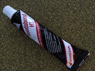

Make sure the mating surfaces are free of oil and there are no burrs that would prevent good contact all around. I use a small flux brush to dab as thin a layer as possible on both the top and bottom case surfaces everywhere they contact. Even the clutch side. Don't forget the two points in the interior where the two studs penetrate the top case. If you happen to slop any in an oil passage, just wipe it out. There's a tightening pattern in the shop manual that probably should be followed.
Hondabond HT.jpg (28.96 KiB) Viewed 2944 times
Post by LOUD MOUSE » Sun Oct 04, 2015 6:17 pm
What is that?. ....lm

What is what??? I didn't see your response before I posted.
Post by LOUD MOUSE » Mon Oct 05, 2015 9:59 am
The tube in the pic. ...........lm
48lesco wrote:What is what??? I didn't see your response before I posted.
48lesco
Posts: 721
Location: Olmsted Twp, Ohio
Post by 48lesco » Mon Oct 05, 2015 10:14 am
Hondabond HT, does the picture not show up? "For use in applications not requiring solid gaskets"
http://prohondaoils.com/wp-content/them ... og2012.pdf
It's worked well for me. You can use Hondabond 4 if you like it better.
