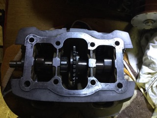

Hi,
Because my original sprocket was broken I bought a new one. Luckely it was availible.
Can someone tell me what the function is of the metal blocks mounted to the original sprocket? I assume that these are for balancing?
See pictures

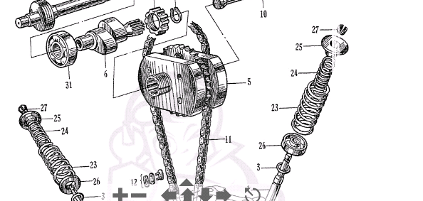

Post by Ericvanrijn » Mon Aug 24, 2015 7:40 am
Original, Item 5
original
original

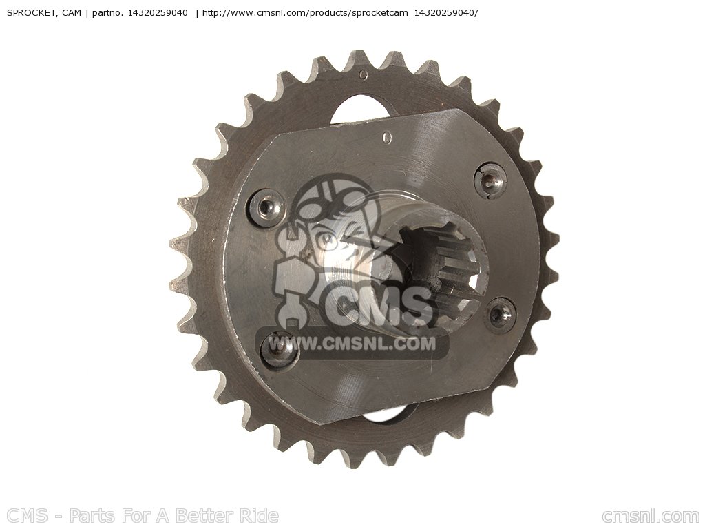

Post by Ericvanrijn » Mon Aug 24, 2015 7:44 am
This is what I am going to receive
Re: Sprocket cam balance weights?
Post by G-Man » Mon Aug 24, 2015 9:12 am
The original large sprocket was indended to damp out torqe fluctuations and give the cam chain an easier ride. It acted like a small flywheel but was later deemed unnecessary.
Ericvanrijn wrote:Hi,
Can someone tell me what the function is of the metal blocks mounted to the original sprocket? I assume that this are for balancing?
See pictures
Ericvanrijn
Posts: 22
Joined: Sat Aug 22, 2015 2:29 am
Location: The Netherlands
Post by Ericvanrijn » Mon Aug 24, 2015 10:28 am
Hi G,
Thank you for this info! So installing the new sprocket without those wheight is no problem?
G-Man wrote:The original large sprocket was indended to damp out torqe fluctuations and give the cam chain an easier ride. It acted like a small flywheel but was later deemed unnecessary.
Post by G-Man » Tue Aug 25, 2015 12:37 am
You'll be fine, providing you have the correct sprocket for your bike. The dream sprocket has a different advance/retard mechanism from CB and CL.
