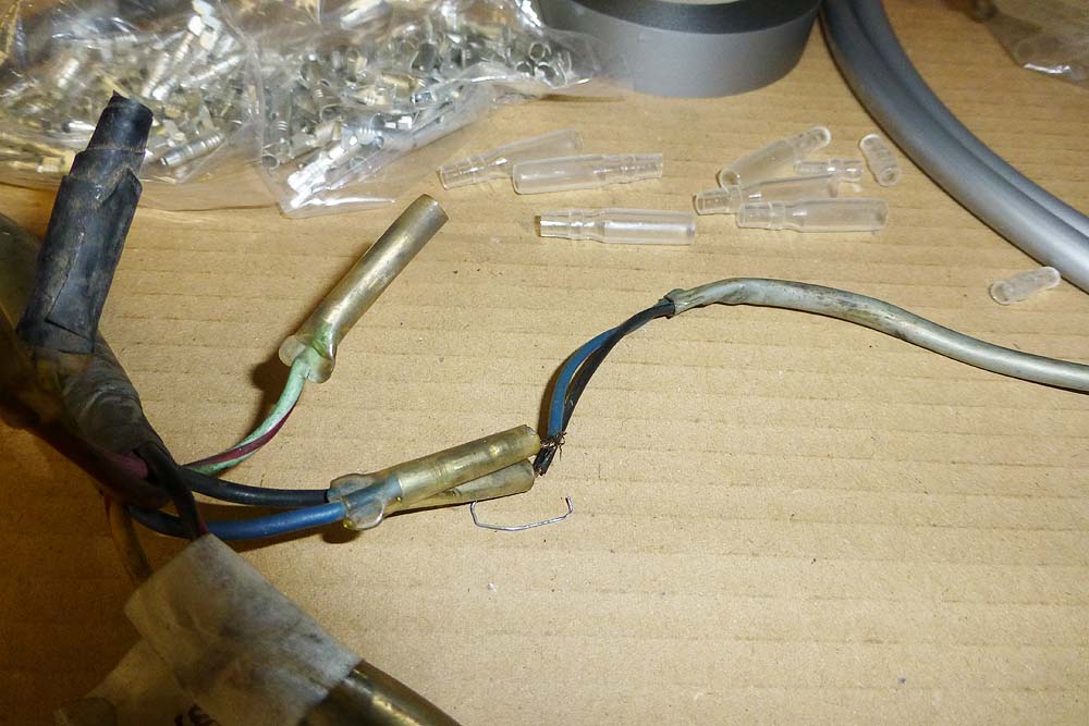

Got the new cabling, sheathing, tape, connectors & shrouds, in readiness to start making the new wiring loom when I noticed that the original soft-clear shrouds are somehow 'welded' to the cable, looking closely, they appear to have been in a sort of clamp or possibly a heated plier as they have a flattened area.
Anyone know how this is/was done??
I might experiment with an old pair of pliers heated over a burner to see if I can replicate it.
Any suggestions??

They were, indeed, crimped under heat.
I would be inclined to use heat-shrink tubing and just heat the end affixed to the wire.

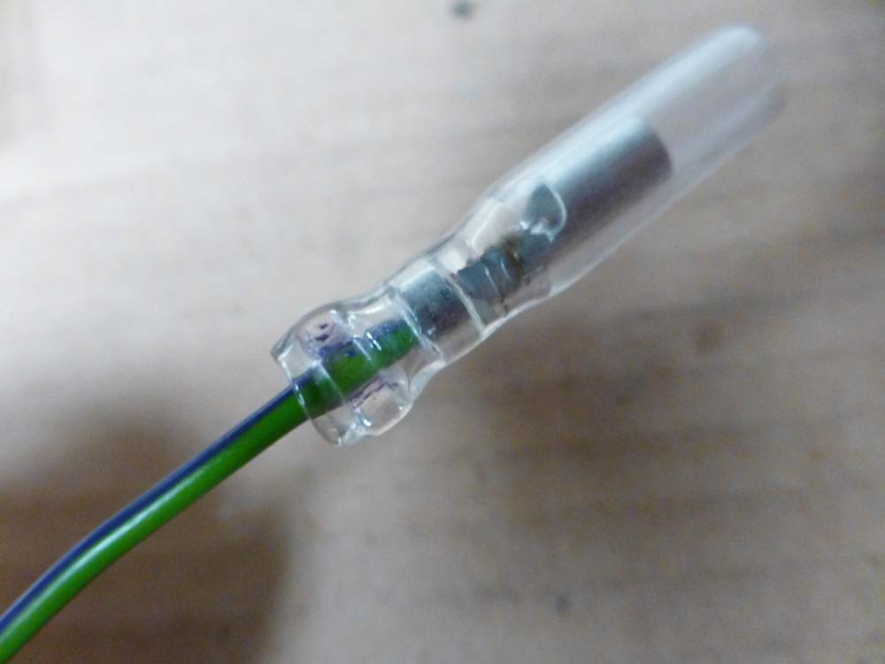

Tried a few ideas without much joy, then I managed this: not a million miles from original, I think I'll settle for that.

Post by G-Man » Thu Aug 06, 2015 11:01 am
That looks excellent!
Can you share the details?

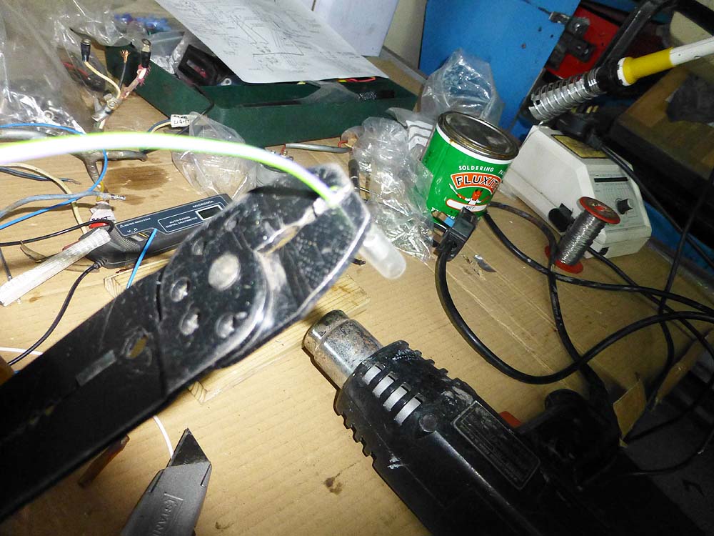

Not very sophisticated I'm afraid, the the bullets, sockets & shrouds are from Vehicle wiring products ( for Japanese bikes) & the latter are made from a very soft-clear vinyl like material.
I tried flame-warming various grips & pliers, but the vinyl simply deformed then sprung right back to original!!
Then tried flame-warming the sheath itself, but as soon as it got to a deformable temp, it started to burn & 'brown' from the flame'heat.
Next up I fired a paint stripping heat-gun as I rotated the connector, this got it really hot & 'squishy', a cheapo crimp-tool was then used to crush the almost liquid sheath, held for 5-10 seconds & that was it.
BTW, they are crimped first, then well soldered, never been a fan of crimp only connectors.
Its a bit micky-mouse, & probably NOT fully welded to the insulation as per original, but it doesn't move if its given a good 'tug', so I'm relativity happy with that.
