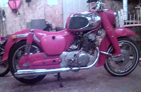

I picked up a 1967 CA77 with no mufflers that I intend to turn into a rider. The price of replacement mufflers is insane so I'd like to go after-market but most sites have a "model lookup" for finding parts and don't go back to 1967.
I am thinking of hotdog mufflers.
Anybody used after-market mufflers? Which ones did you get?
Thanks!

Hi Dianne, These sound really good and "deep". I put the EMGO 80-84034 mufflers on mine. I bought them on Ebay for about $125 with shipping for the pair. (they cost a bit more now) You have to make sure you get the rear bolted on good so they don't move. The front clamps are tight but leak a tiny tiny bit. I am thinking of making a thin shim to close up that tiny bit. But this is probably not really necessary.
SEE photos and the WHOLE post about aftermarket mufflers HERE:
http://www.honda305.com/forums/mufflers-t7635237.html
Jim

I also am a fan of the Emgo Dunstall Replicas. I use aluminum pop cans cut up to shim the front clamps.
They look good, they're cheap, they sound nice and even if they rot out in a few years, $100 isn't a big deal.

Yes, you mentioned this to me about shimming with a Soda (pop) Can in another post... I now just have to DO IT! HAHA!! I figured when I take it apart I would shim it better. For now? well, it works pretty good!

Thanks Jim! My EMGO mufflers came in yesterday and I was trying to figure out how the heck to support the muffler. Two bolts in the muffler is a more simple and elegant solution than the bracket ideas I was playing around with!

Got the mufflers on - sounds GOOD!
The side stand hits the left muffler - what did you use for a bumper?
