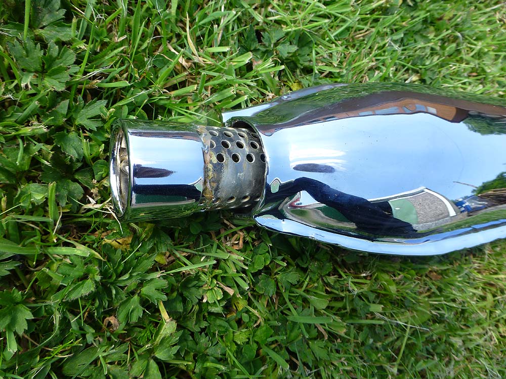

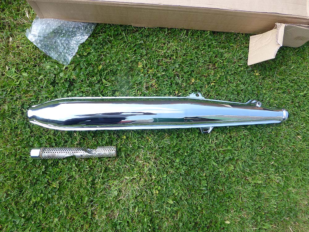

Anyone bought these??
Got mine the other day with other stuff, unwrapped & initially pleased, but when I tried to insert the baffles, they stopped short as they hit something inside, probably something simple such as a bit of grinding, but I would have thought whoever manufactured them would have at least tried them for fit etc.
Its not a one off however, BOTH the same, even tried swapping them around, same problem.

Oh dear, mine look the same as yours, but I won't know for months whether they will fit or not!!
That elongated mount-hole looks a bit 'amateur/bodge' to me.
But my original question is still about the fitment of the baffles, do yours go all the way into the body??

Only tried one and yes the baffle do's go into the silencer, I have not opened the other silencer box as I do not wish to use them if the right side do's not fit.
Have you shone a torch in the end to have a look to see if there is any obstruction.

I have recently bought a pair of these. They line up perfectly with the mounting points though neither of the baffles would go completely into the ends of the silencers. Careful inspection revealed that this was because where the indents had been formed in the baffle tubes the compression had forced material outwards such that the diameter perpendicular to the indent is increased slightly and will not pass through the holes in the baffle plates in the end of the silencer. A few minutes work squeezing the baffles back into a more circular cross section at these points in a vice solved the problem. It's a shame that this wasn't picked up by the manufacturers as otherwise these are nice looking silencers and good value.
