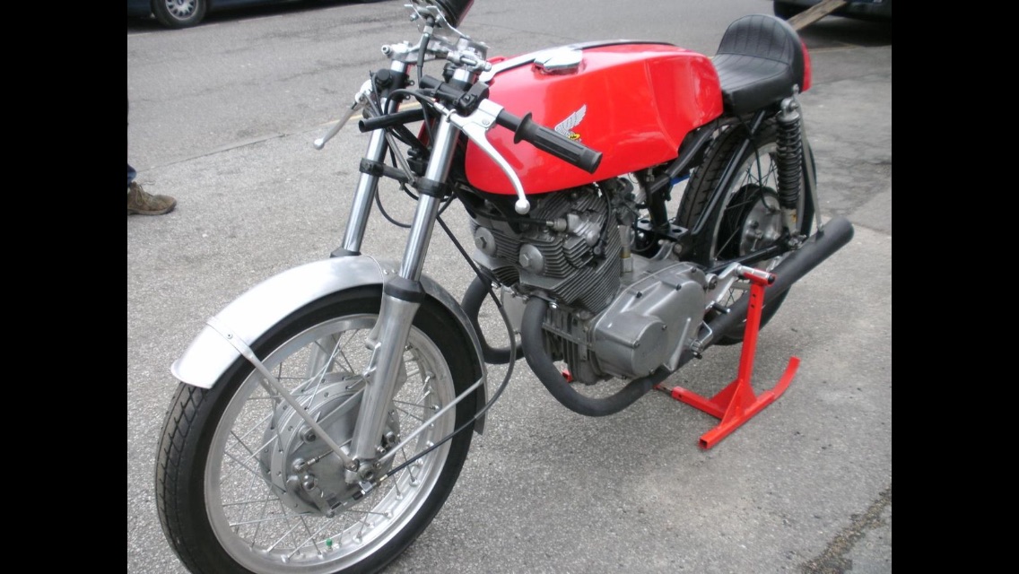

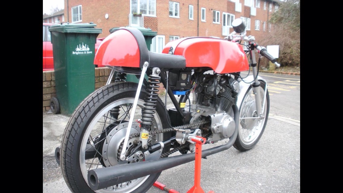

Some pictures posted. Fairing on (just, not quite right but it's the one it came with). Next it stop the leak and then look at megacycle cam/nova 5 speed box and a bit of head work.

- image.jpg (110.2 KiB) Viewed 5183 times
- image.jpg (117.42 KiB) Viewed 5184 times
- image.jpg (154.63 KiB) Viewed 5184 times
