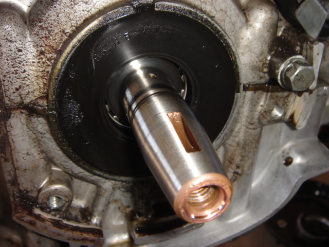

LOUD MOUSE wrote: The seal seals the shaft and the oil to the starter sprocket comes through the center of the shaft and out a hole in the shaft.
Best of luck. ..................lm
I just happen to be uploading camera pics onto my computer of the same seal in this discussion, so I will show one here. This is the oil hole in the crankshaft LOUD MOUSE is talking about. The two black rings on the shaft are residue from the seal on the starter sprocket. They cleaned up nicely prior to installing the starter sprocket with new seal.

Post by LOUD MOUSE » Sun Apr 26, 2015 1:37 pm
Thanks for sharing. ............lm
