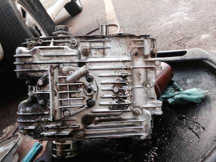

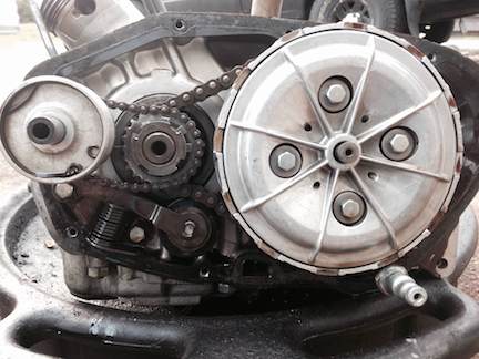

Anyway I am in the process of rebuilding the transmission and engine, and found so much useful info on here that I thought I should contribute instead of just lurking!

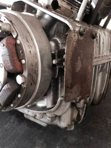

Earlier this week I cracked the cases and started cleaning them up.
I attached some photos i took during disassembly. Not all of these photos are particularly relevant but also this is useful for myself as a reference for rebuilding.

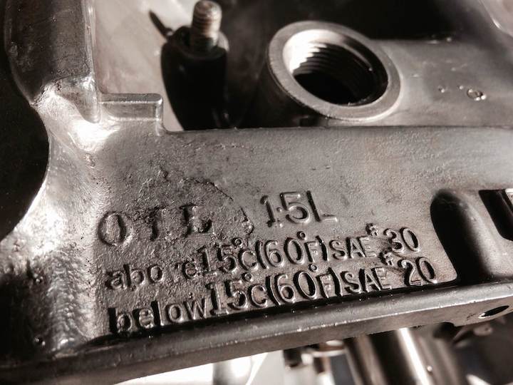

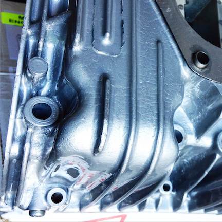

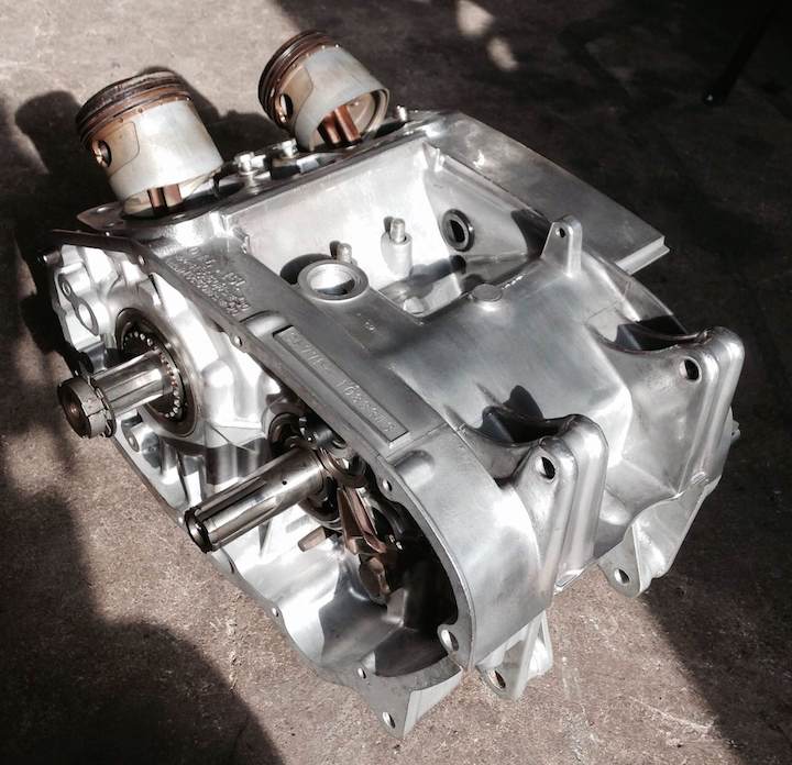

This project was a good excuse to hook up the vapor blaster I bought a while ago. It is awesome. Here are three photos of before, after vapor blasting, and then after applying clear powder coating.
before
before
With clear powder coating

Transmission still needs a few things before it can be buttoned up.

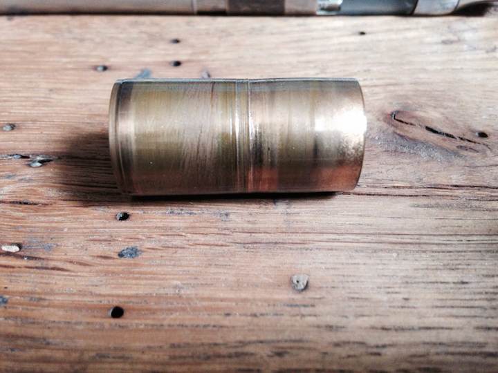

Bushing C in the kickstart gear is totally trash. There isn't even any of the ridge left at all. This probably explains why all those gears seemed real sloppy.

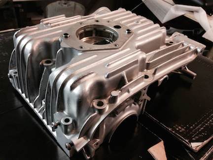

Also was able to set cases together which is exciting! I am very pleased with how the powder coating came out on the cases. I intentionally left a little dirt and roughness, and it came out just how I wanted it (see the close up)

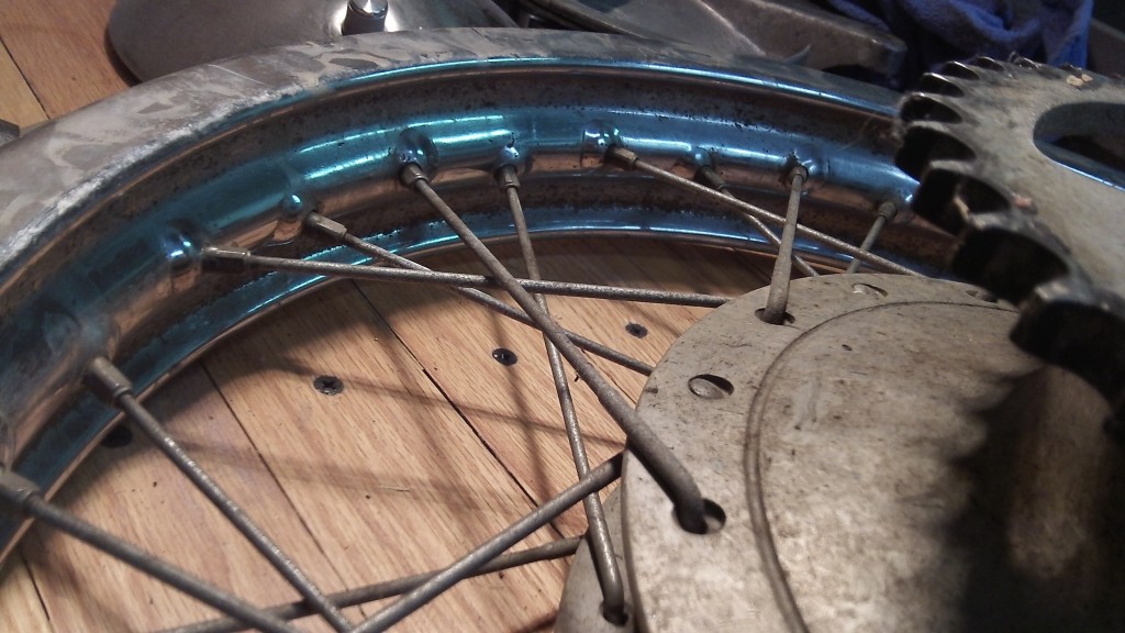

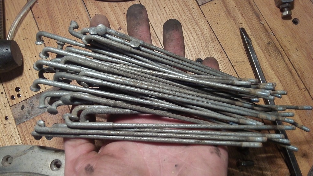

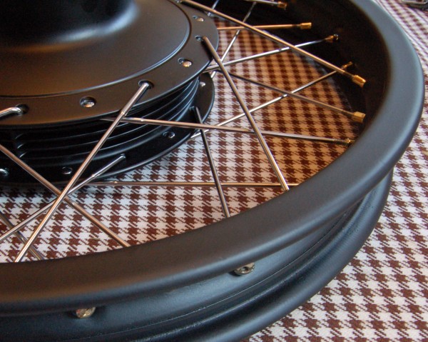

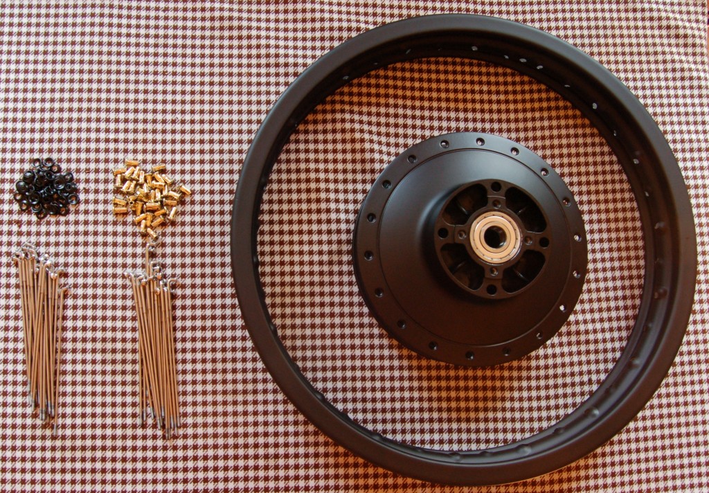

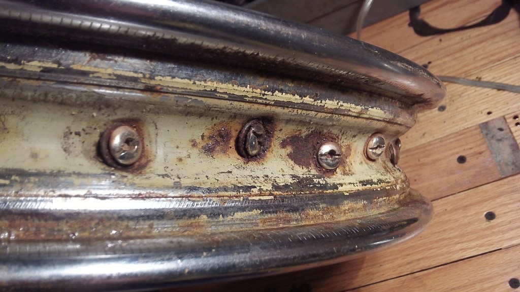

Here are some photos I found of my wheel rebuild, the chrome was junk and the rims were pretty pitted so I powder coated them. Im not wild about the black, maybe some day I will rebuild with chrome.
jugger18
Posts: 117
Joined: Mon Aug 10, 2009 10:01 am
Location: Madison, WI
Post by jugger18 » Tue Apr 21, 2015 1:01 pm
You could always try the chrome powdercoat? I would love to know more about your vaporblasting setup.
