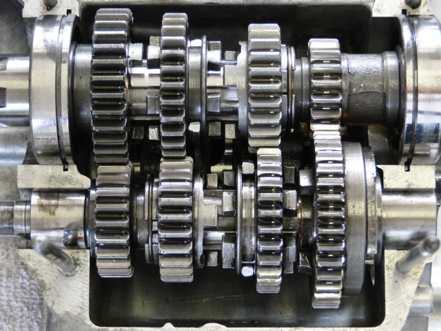

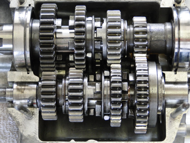

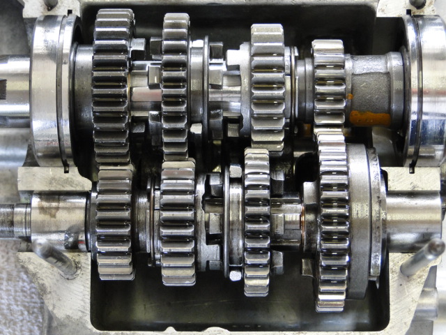

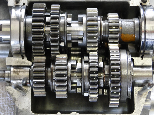

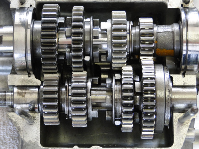

CMS - I think your dogs are worn. The pics show the gear sequence on a CB77 and how the dogs engage. The CA77 transmission is very similar, except that the dogs are not "undercut" like the ones shown and are more apt to disengage especially if there's some wear in the shift drum, forks, etc. and they aren't completely engaged to start with. You'll have to split the cases to find out what's worn, but you can find NOS and good used parts to fix it.
5 Fourth.JPG (67.03 KiB) Viewed 4913 times
4 Third.JPG (67.37 KiB) Viewed 4913 times
3 Second.JPG (67.37 KiB) Viewed 4913 times
2 Neutral.JPG (66.82 KiB) Viewed 4913 times
1 First.JPG (67.43 KiB) Viewed 4916 times

Nice PIcs..............so one dog went for a walk!

Any body have a good picture of shift drum, shifter cams, shifter forks, etc.??? And, maybe the location of drum, cam, forks in transmission. Thanks again and------"Keep 'Em Rollin' "
bamacl
Posts: 124
Joined: Tue Sep 16, 2014 3:24 am
Location: mobile
Post by bamacl » Thu Apr 09, 2015 8:18 pm
The shift drum is in the top engine case above the trans. The shift forks fit over and ride on the drum. The "cams" are not parts but machined channels in the drum that guide the forks movement for proper gear selection. Look at the pictures, top shaft / 2nd gear from left, bottom shaft / 2nd gear from right are the "slide" gears. They are the ones that move left or right for gear change. You can only see the tips of the shift forks on them. Now all that said and not to be an a-- but you really need to pick up a shop manual before you try to tackle this job. If I were closer I would be happy to help you.
