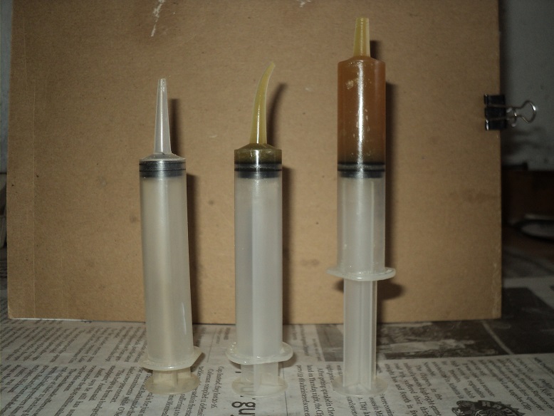

These are originally meant for wood glue.
At least one of them has a new career as a mini mini grease gun.

G-Man wrote:Nice job. Every toolkit should have one!
And they are cheap, which is good because petroleum products will probably attack the rubber over time.

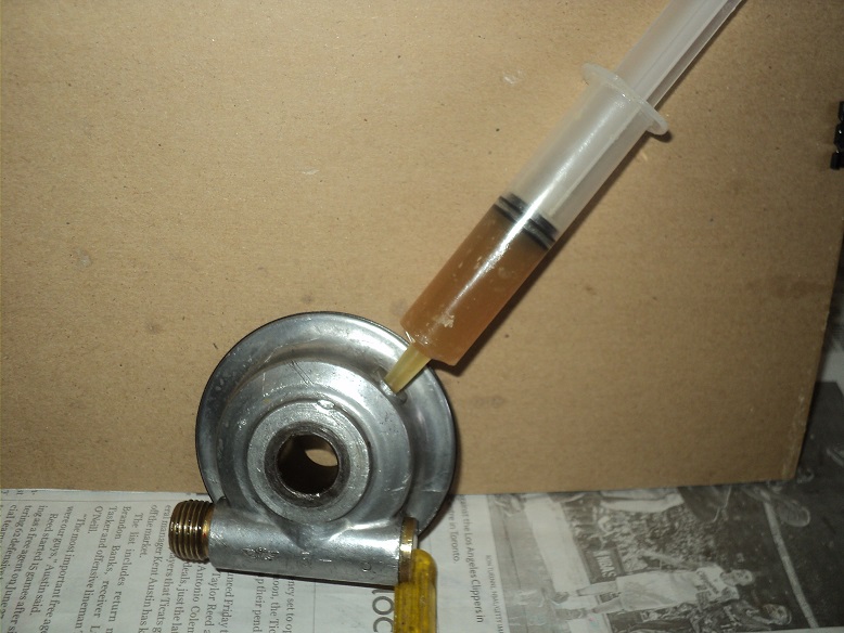

The one with the curved tip has a very small hole. Would work with #90 gear oil, but probably not grease. The one I used for the speedo drive was cut to give it about 1/8" opening.

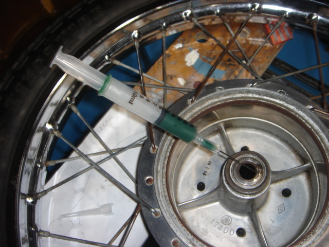

Oh yeah, it will work with grease. Here I'm getting grease to the bearing by slipping under the cover with a large bore needle attached. You have to press really hard, but it works great.
