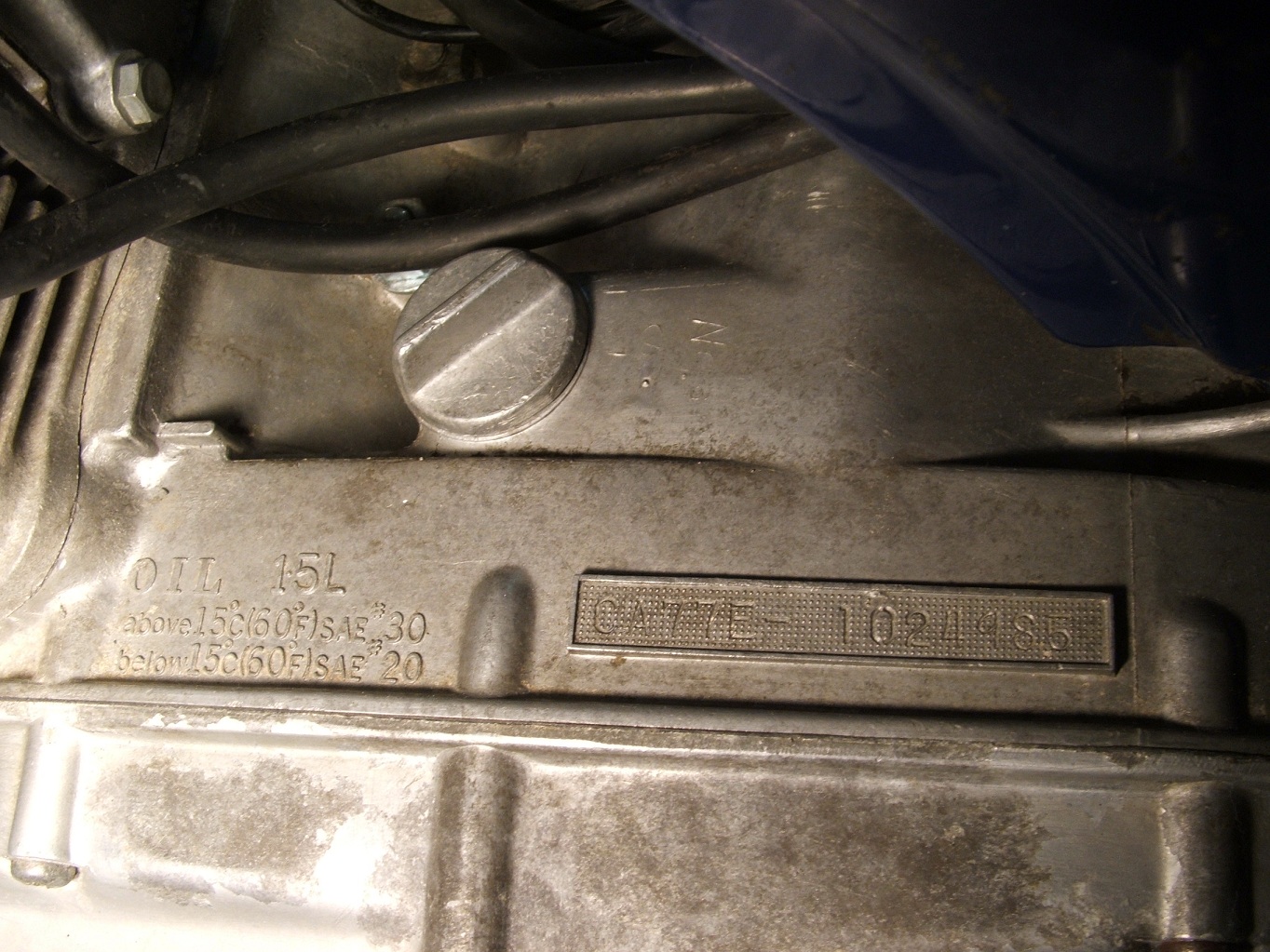

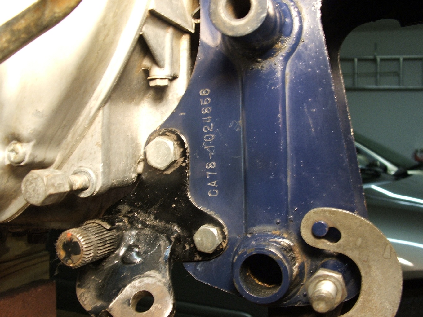

1700 miles is very low, but I would still take the steps above especially with the fuel system. Time is more critical there than mileage. Also, it's important to know the VIN's on the frame and engine in order to get the right parts and other info... Pics show where to find the frame and engine numbers. They are normally a few hundred off. The number on the Ohio title should match the frame number. C72 would be an early 250 Dream model I think only sold in 1961 in the US. Probably a typo if the frame is a CA78-XXXXXXX and the engine is a CA77E-XXXXXXX. Let us know what you find...
- Pics 011a.jpg (186.96 KiB) Viewed 4030 times
- Pics 012a.jpg (213.62 KiB) Viewed 4029 times
Hey there thanks for the pics. Where are the frame numbers located on yours? I have a baby dream frame laying around and its vin is by the battery box and straight. The bike has a green paint job and has had two previous owners i see on the title could they have painted over it? U can tell it wasn't done professionally and there are no places where it looks to have been scratched up as to hide the vin number.
