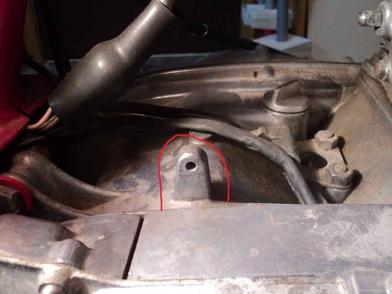

Post by R100 » Sun Jan 25, 2015 2:05 pm
Cannot find any reference to it.

Post by LOUD MOUSE » Sun Jan 25, 2015 2:31 pm
The upper case casting is used for all 250/305 engines.
That is a threaded post for the Right Side Carb Cover of the DREAM engines...........lm

Post by R100 » Sun Jan 25, 2015 3:00 pm
LOUD MOUSE wrote:The upper case casting is used for all 250/305 engines.
R100 wrote:Cannot find any reference to it.
Thanks.
When I couldn't figure it out I thought - "I must be Dreaming!"

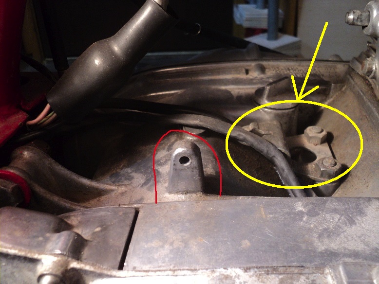

Post by Seadog » Tue Jan 27, 2015 9:46 am
Thanks for asking about that - I didn't know what it was for either, since I don't have the carb covers yet.
Now, could LM or someone else identify the other bracket in the photo. I can't find reference to it in the parts list and I don't have one. Thanks!

Post by Hoosier Tom » Tue Jan 27, 2015 10:13 am
That's for the valley cover pan to fasten to on Hawks and Scramblers. Dreams don't have them as they have the carb dust covers.

Post by Seadog » Tue Jan 27, 2015 10:16 am
Hoosier Tom wrote:That's for the valley cover pan to fasten to on Hawks and Scramblers. Dreams don't have them as they have the carb dust covers.
HT
Thanks Tom. Phew! I thought there was yet another part I had to search for!
