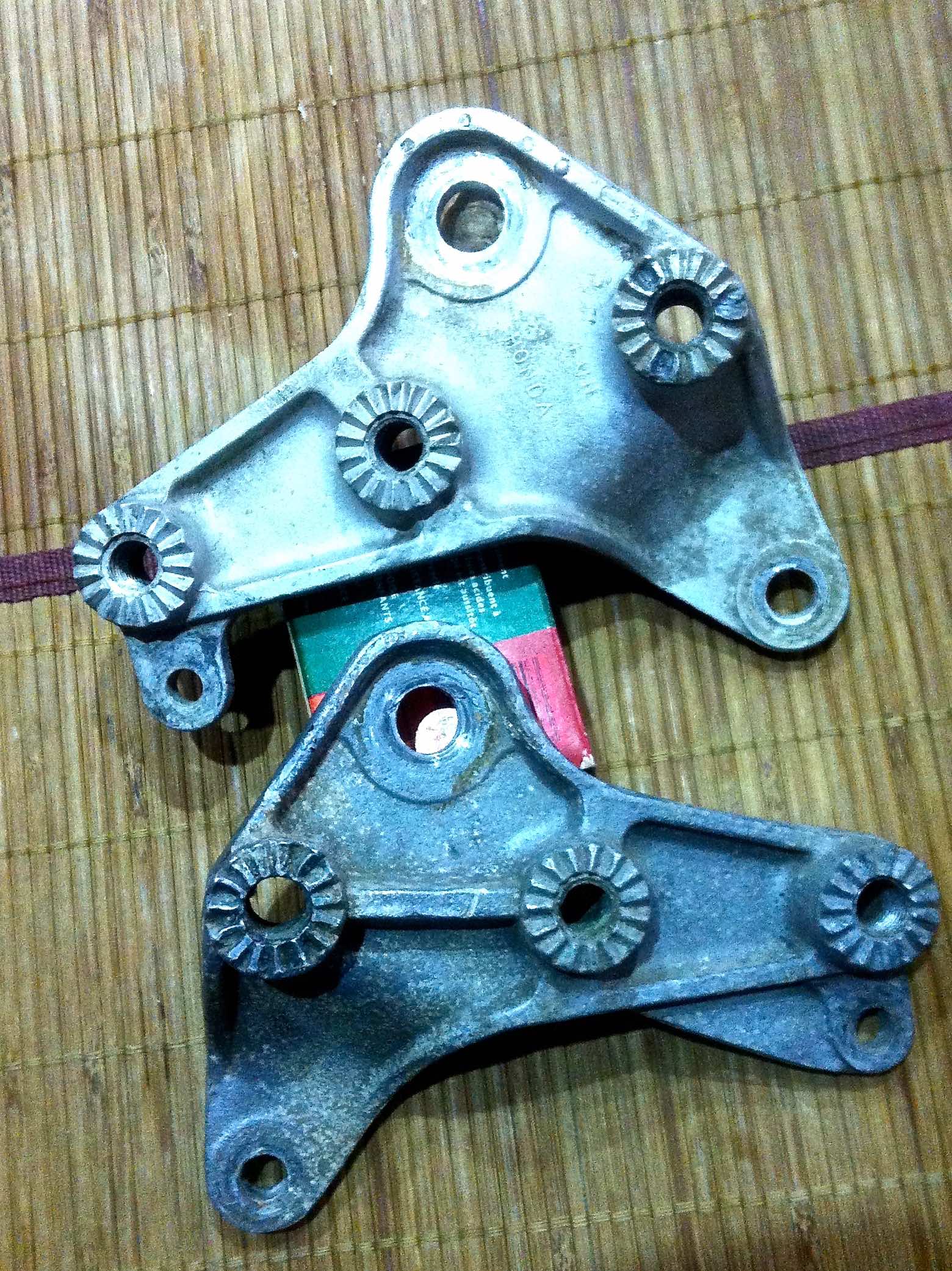

what 's this bracket ??? genuine or adaptable ???

Post by LOUD MOUSE » Tue Dec 23, 2014 7:31 am
Standard on all Hawk/Super Hawks.
Rider peg was installed on the front hole or could be moved to the middle or rear one with the changing of the length of the shift rod.
Usually the rear hole was for the passenger peg. ...........lm

Not sure if he is talking about the difference in casting between the two.
I imagine they are both genuine
Post by LOUD MOUSE » Tue Dec 23, 2014 8:28 am
You may be right but I see a right and a left side and I've never seen reproductions of these parts. ......????????????. ......lm
Waveblaster wrote:Ed

that is exactly what i mean !!!
Post by hondauser » Tue Dec 23, 2014 2:28 pm
the difference between left and right bracket !!!
i dont care if they are original or after market !!!
but i see a little difference !!! not you ???
and i ask the guru if they know what !!!
a kind of kwiz fo the end of this magnificent year !!!

The pic here is so large I wasn't seeing the entire part.
The top one (right side) is the more common (USA) issue and I've never seen the bottom issue.. ...........lm

Top looks die cast with 'HONDA' name in and bottom one sand cast, a friend of mine showed me a collection of them recently, I think he said he had seen 3 different styles, I can check with him for more details if you require.
