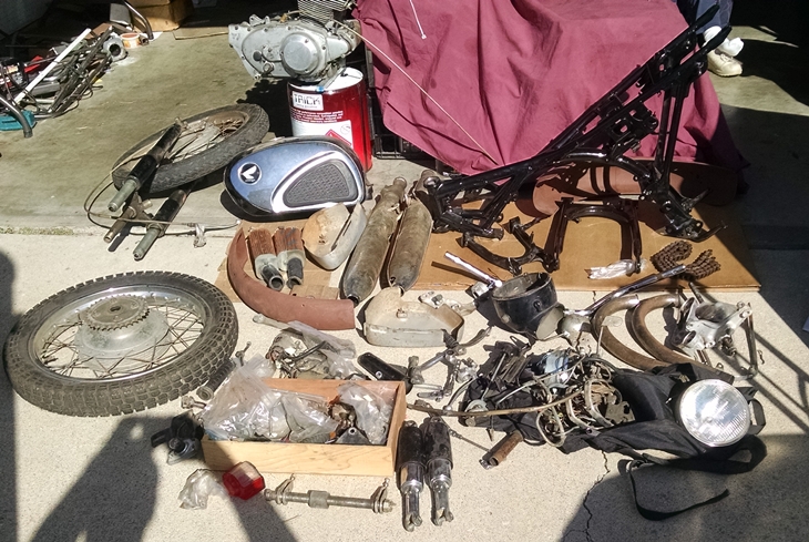

I'm new to the forum. Just wanted to introduce myself. I just bought a 1966 CB77, in many pieces - photo below. Back in the day, I had a CL77.
I was about to start sending out parts for chrome and powder coating when it occurred to me that I should probably first check that I actually have enough parts to put a motorcycle together. So, I started assembling, and found that not much is missing. I've started ordering those parts that are missing or in need of replacement. I've also started realizing I'll need lots of advice as the project moves forward - this forum appears to be a great place for such advice.

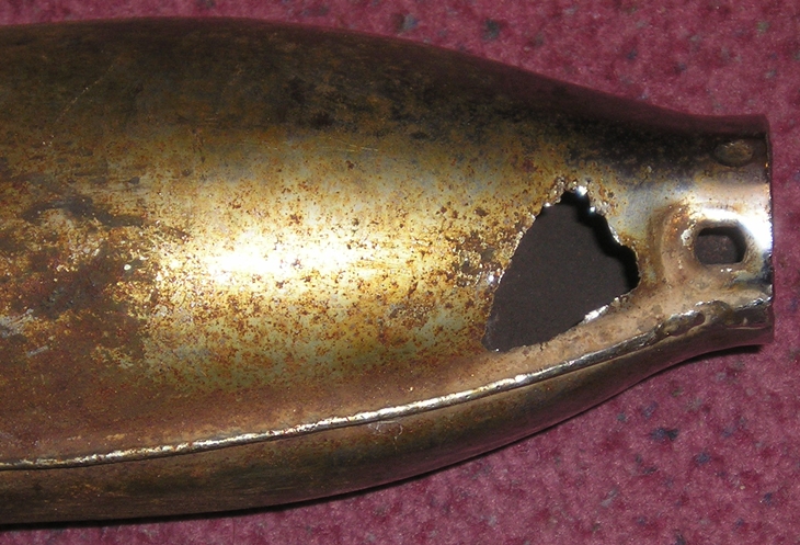

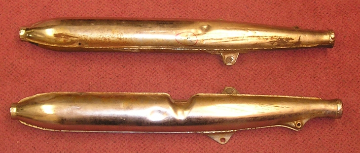

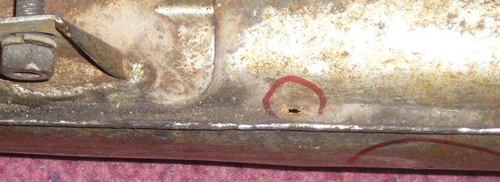

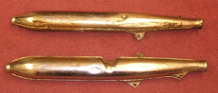

First item - mufflers. Mine are in such bad shape that it's not clear I can restore them for less than the cost of good reproductions ($1,400?). The right one has rusted all the way through in a few spots. I'll be looking for original mufflers in better shape than mine. Photos below, suggestions welcome. I'll put up a post in the Wanted section of the forum on this subject.

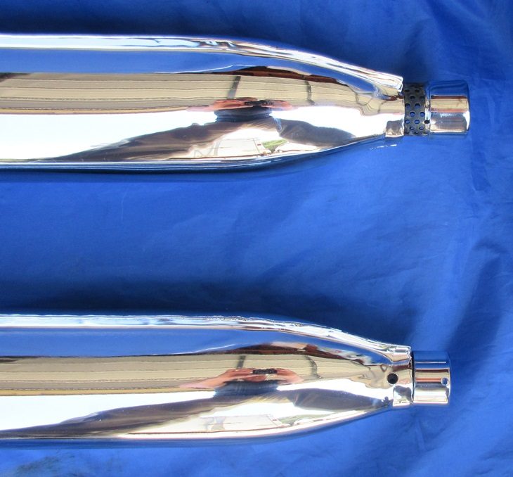

Steve,

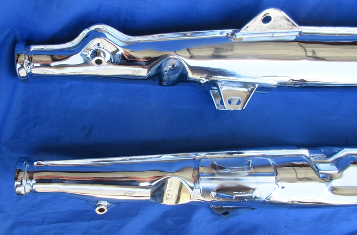

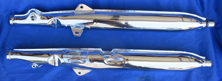

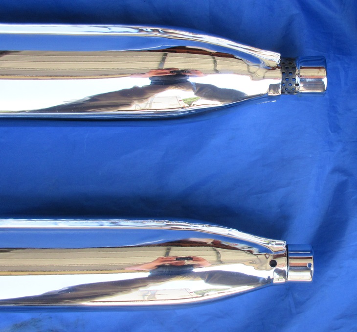

Here are some photos of the mufflers.
They came with diffusers, which will require some fussing / fitting / finessing to install - that's why they are not in all the way.
Phil
Phil

Thanks Phil
They look like the same manufacturer as mine. Did you mention earlier whether they have drain holes or not? My mystery set doesn't. If yours don't either, because of the amount of rust on my baffles I am going to speculate mine are a set of DSS mufflers that got side tracked and lost for a number of years. Thank You very much for the the helpful information.
Steve
