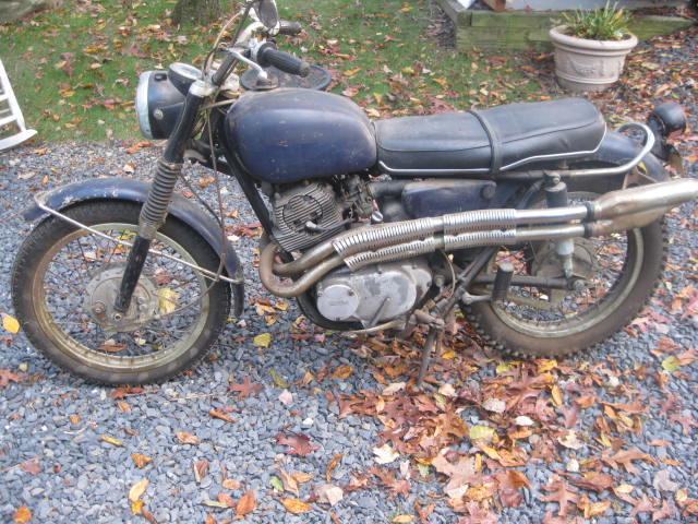

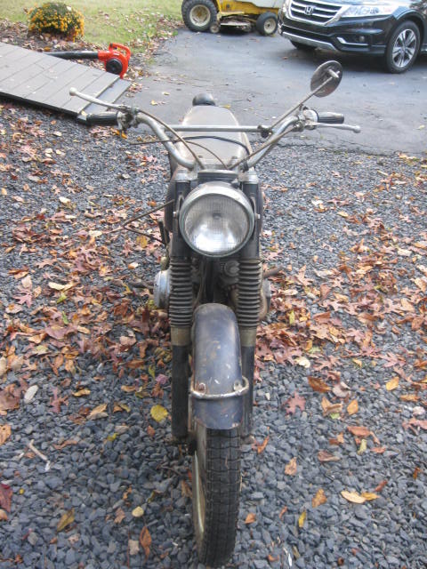

Looking for help with this cool bike. Not sure how far I want to go with a resto. Perhaps a good clean up, tune motor after leakdown / compression test , breaks, wheels, steeringhead ,swingarm bearings prep etc. I would like to get tank badges back on for some strange reason. I think there is bondo over the emblem area. I bought the bike from the second owner who had the bike since 73. To be continued.
What ya think.
Honda CL 77 001.jpg (86.04 KiB) Viewed 2169 times
Left side

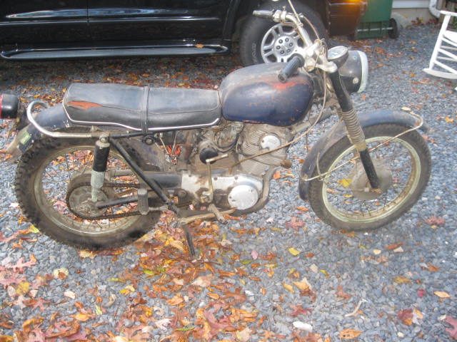

R side
R side
Honda CL 77 003.jpg (74.35 KiB) Viewed 2169 times

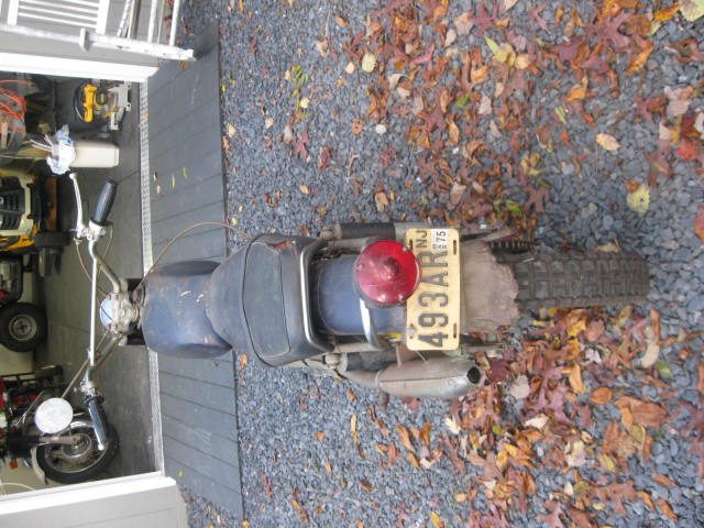

rear,,chopped fender ?
Honda CL 77 002.jpg (72.07 KiB) Viewed 2169 times

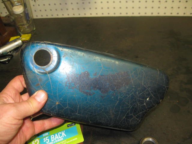

Oh this is a example of the OEM color I think ?
What is the name of the color ?
Much thanks !

By physical appearance, since I don't know what your frame and engine numbers are, it looks like you have the early small hub CL77 which came out in 1965. The tank, side covers and both fenders would be silver. The frame and rest of the painted parts would be either black, red, or blue.

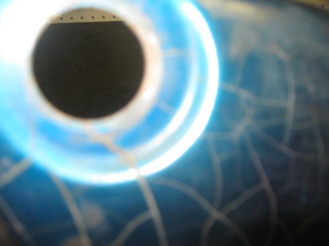

The frame is Black and has minor rust in some arera's.The prior spray bomb paint covered the what appears to be a blue /turquois color.
Color ?
Color ?
Honda CL 77 006.jpg (39.29 KiB) Viewed 2130 times
