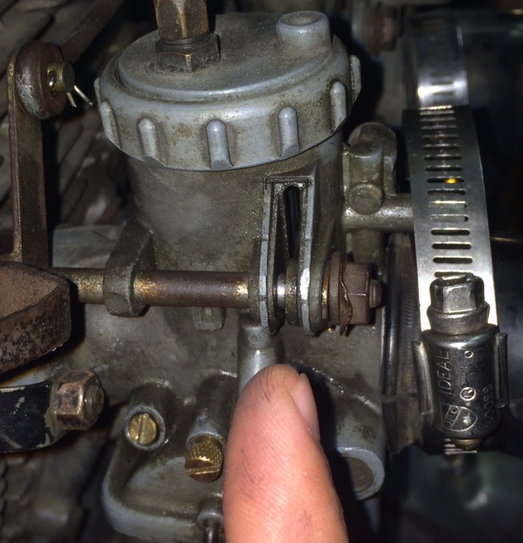

Hello, I am rebuilding my carbs and have no clue what is needed to air seal the space where the choke lever is mounted. In others photos on the web it seems I need a white rubber sealer? The part is not in my model year catalog. And can't find it. Anyone know what I'm looking for?? Thanks.

It's just a piece of of flat aluminum bent to that profile peened and glued in to place.
ImageSquare bowl carb by graham.curtis, on Flickr

Do you know where I can get 2 of these aluminum pieces pre-cut and bent?
Post by G-Man » Wed Oct 08, 2014 1:56 pm
I'm afraid you will either have to rob some scrap carb bodies or you will have to find someone who can snip some aluminium and fit it to the carb.
Not a hard piece to make...

Post by Dmc89 » Fri Oct 10, 2014 8:52 pm
Thanks again g-man. I found some scrap alumin sheet that is the right thickness army work and should do the trick.
