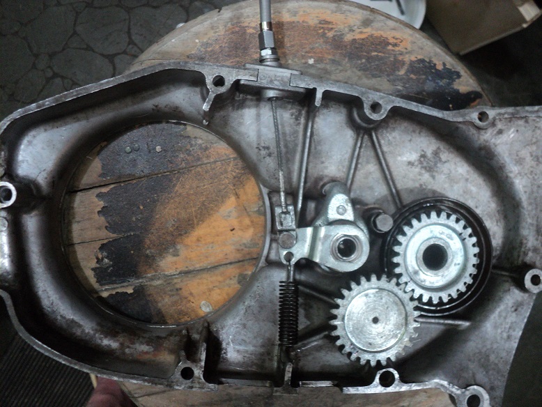

As someone posted previously, the clutch thread arm should rest at about 7 o'clock in order to get proper leverage. Mine rests at 9 o'clock with both adjusters backed off completely.

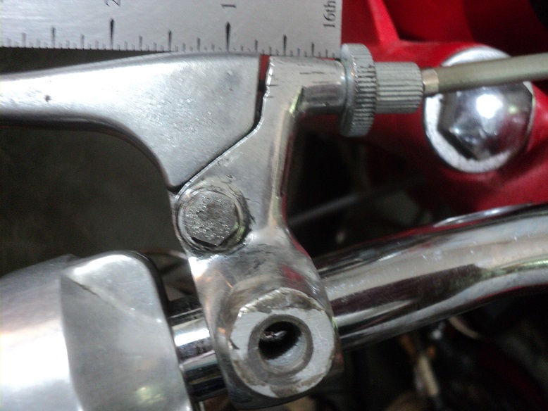

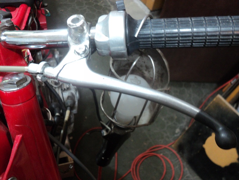

I suppose it could be the lever and perch, but I have nothing for comparison. They look like they could be original (scratches, dings, iffy threads) but original what? CP77? CB77? Other?

with clutch basket screws/springs backed off I can operate the clutch in/out with my right thumb on the rod end and left hand on the basket

In the first picture it appears that you dont have enough free-play in the cable. The arm of the release mechanism and the clutch cable are already past 90°. When the clutch lever is pulled in they will nearly in a straight line, that will make the clutch real hard to pull. You need a different cable or remove about 1/2 inch of the outer cable to get more free length. When the cable is the right length the release arm and the end of the cable will form a 90° angle when the clutch lever is pulled all the way to the grip. When the cable is set to the right length, then mount the cover on the engine and make the clutch adjustment by turning the center of the clutch lifter. Set up this way, you have the most mechanical advantage for the lightest pull.

mike in idaho wrote:In the first picture it appears that you dont have enough free-play in the cable. The arm of the release mechanism and the clutch cable are already past 90°. When the clutch lever is pulled in they will nearly in a straight line, that will make the clutch real hard to pull. You need a different cable or remove about 1/2 inch of the outer cable to get more free length. When the cable is the right length the release arm and the end of the cable will form a 90° angle when the clutch lever is pulled all the way to the grip. When the cable is set to the right length, then mount the cover on the engine and make the clutch adjustment by turning the center of the clutch lifter. Set up this way, you have the most mechanical advantage for the lightest pull.
Thanks Mike, that's what I was thinking.
First I might try finding an actual CB77 lever and perch. As I said, I don't know exactly what that one is, but it is a wobbly mess and needs replacing anyway. Then I will have a better idea of how much to shorten the outer cable (fiddly job I bet).
Besides E-Bay, would you know where I can find a lever/perch set that is not "one size fits all" but specifically for a CB77?
