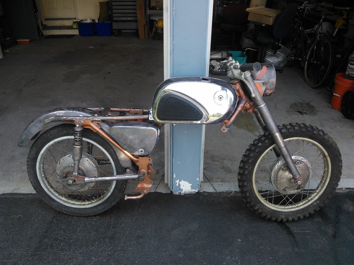

Mmmmm. That looks pretty.

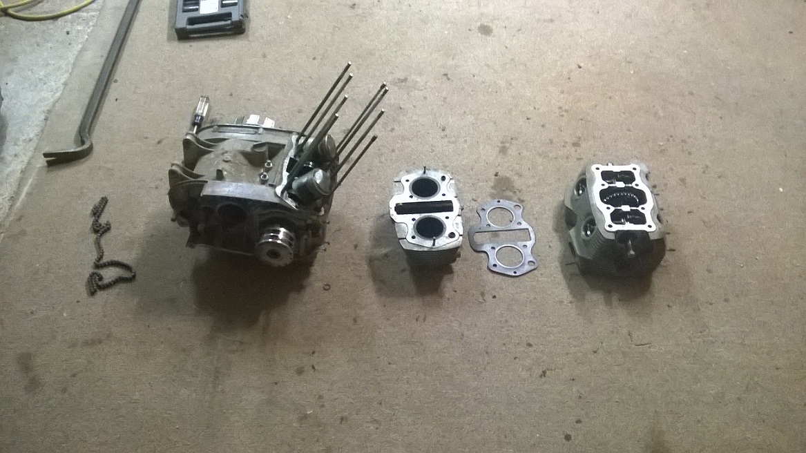

Engine breakdown. Definitely needed some work.

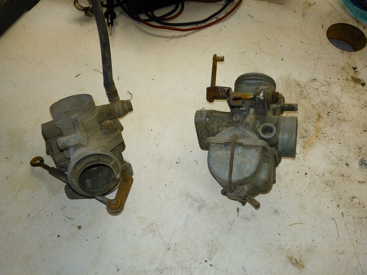

These carbs don't look too good. Not quite sure what I'm going to do with these.

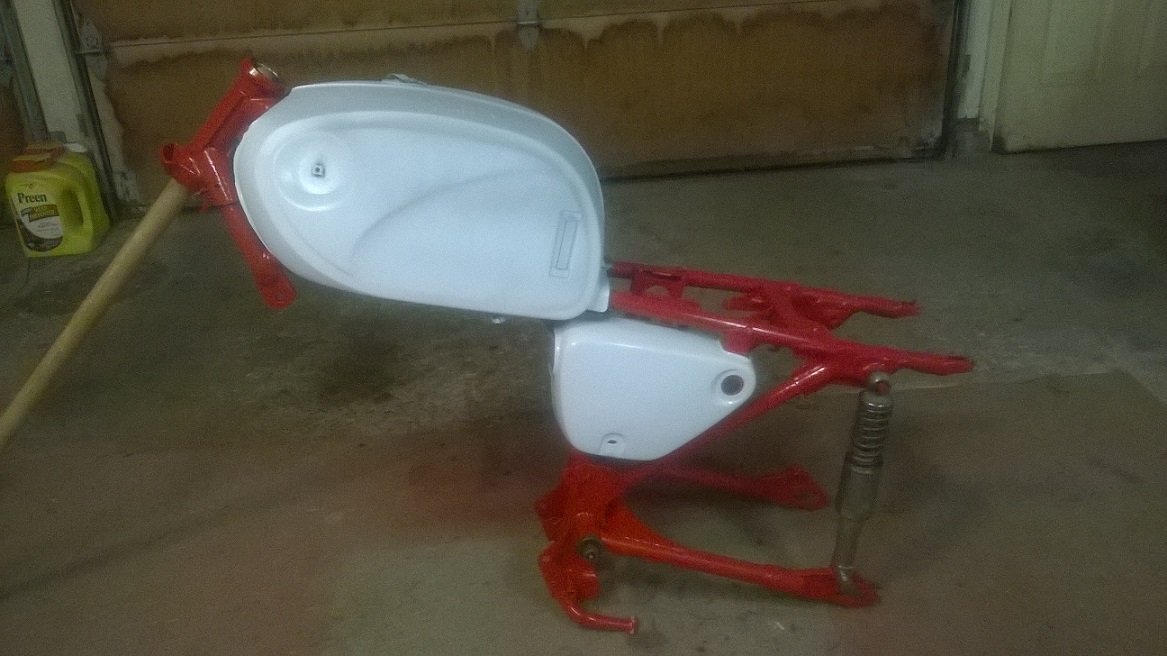

Tear-down and paint stripping.

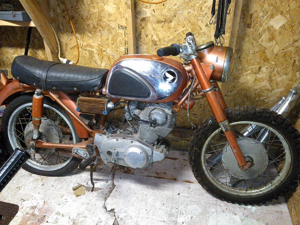

Here's what I found in the shed.

Hi. I think your carbs look perfectly salvageable. Take a stiff bristle brush and degreaser to them to get the loose debris off. Then take them apart so you can get all the jets and valves out .Organize everything into separate and clearly labelled containers for left and right carbs. Fill each container with straight Pine Sol and let soak for a couple days then check progress. Clean your jets with something physically solid like jet cleaning wire or a copper strand. Don't worry about any rubber o-rings; they will swell slightly and then return to size. What have you got to loose? Take before and after photos like you already do. Welcome to the Forum.

400cc = $$$$ if you want any relability. Are you sure these guys are really up for this task? That's gonna take about a 70mm piston with stock stroke. Or are they gonna whip you out a stroker crank too ? Now that would really be cool ! LOL
