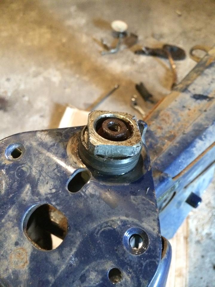

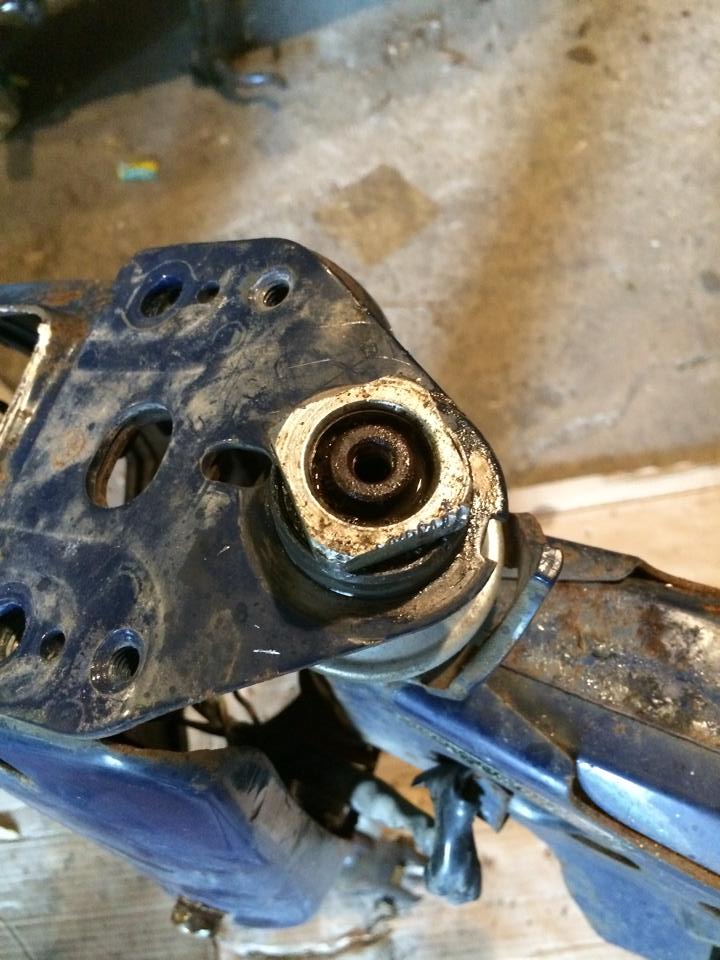

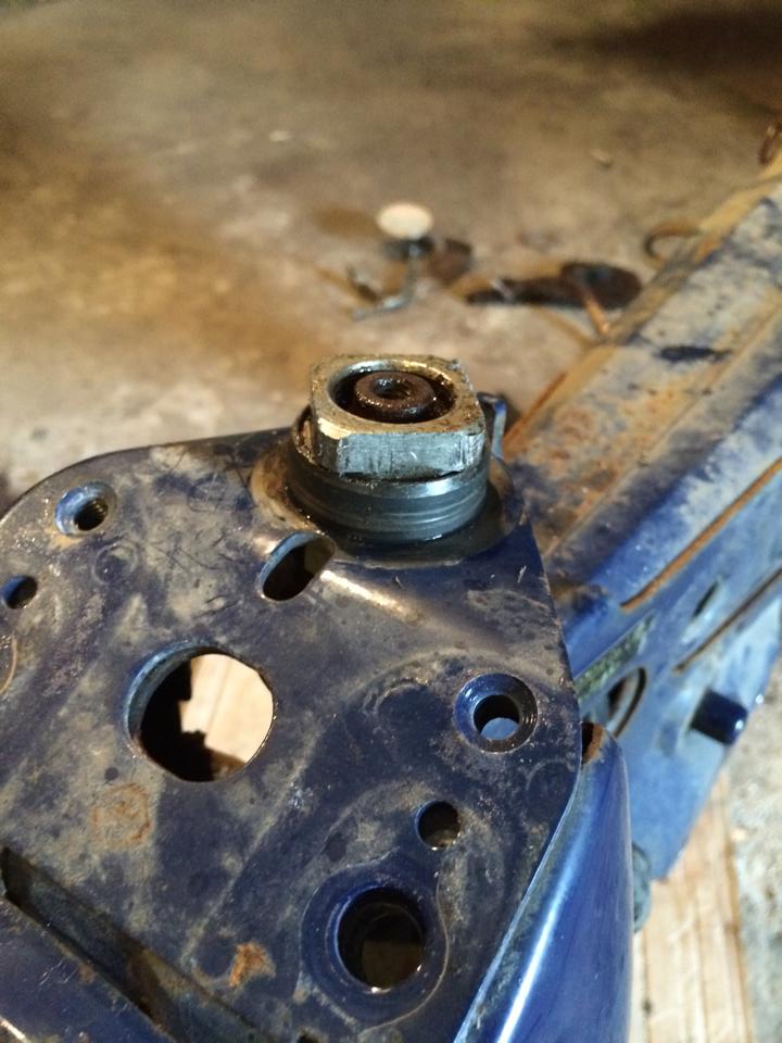

Hello,
Can anyone guide me how to remove the ca72 steering nut stem? I already spent more than a hour but I can't take it out
Thanks,
deafanddiabetic
Posts: 258
Location: Nebraska
Post by deafanddiabetic » Fri Aug 01, 2014 7:03 pm
I just got mine off last night. There's a spanner wrench nut right underneath that fork plate that you need to hold (I used channel lock pliers). If you look at cmnsl.com, it's the #4 nut on the diagram for the forks. That nut needs to be turned right, while you turn left on that top steering nut. It took me a few whacks with a hammer but it came right off!
don111
Posts: 16
Joined: Sun Nov 14, 2010 8:11 pm
Location: Chicago
Post by don111 » Fri Aug 01, 2014 7:24 pm
Hi deafanddiabetic,
Thank you for the guide. Finally, the nut already come off.
