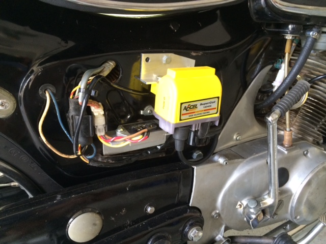

Post by garncarz » Sat Aug 09, 2014 4:21 pm
The starter button isn't even all the way out and its running! With no choke from stone cold. Terrific throttle response.
Here's the set up: Accel 140406 super coil, Accel coil boots and terminals, NGK 7 mm copper ignition wires, tinned and soldered to the terminals, NGK non-resister plug caps, NGK D8HA plugs. And it all fits under the left side cover.

What is that under the coil that the red and yellow wires are attached too? What did you do with your Condenser? Also, I was wondering about this type of 12V coil used on Harley Davidsons; Thoughts?http://45restoration.com/Products/Coil- ... 5-12V.aspx

I replaced the selenium rectifier with a Kohler voltage regulator. The condenser is mounted on top of the cylender head, as usual. AS long as the primary resistance of that coil is 4-5 Ohms, it should be OK.
