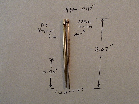

Post by brewsky » Mon Jul 14, 2014 6:50 am
Here is a comparo of the Keyster D3 vs Keihin 22401
