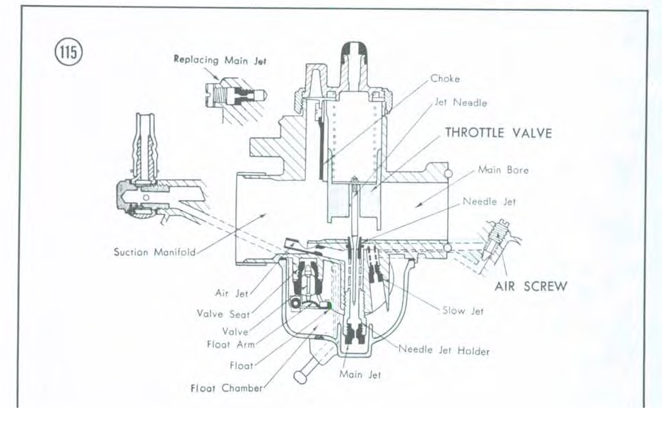

In the mean time, does anyone have a diagram/drawing showing ALL of the passages in the Keihin PW22? I am not sure that I have got everything cleaned out.
