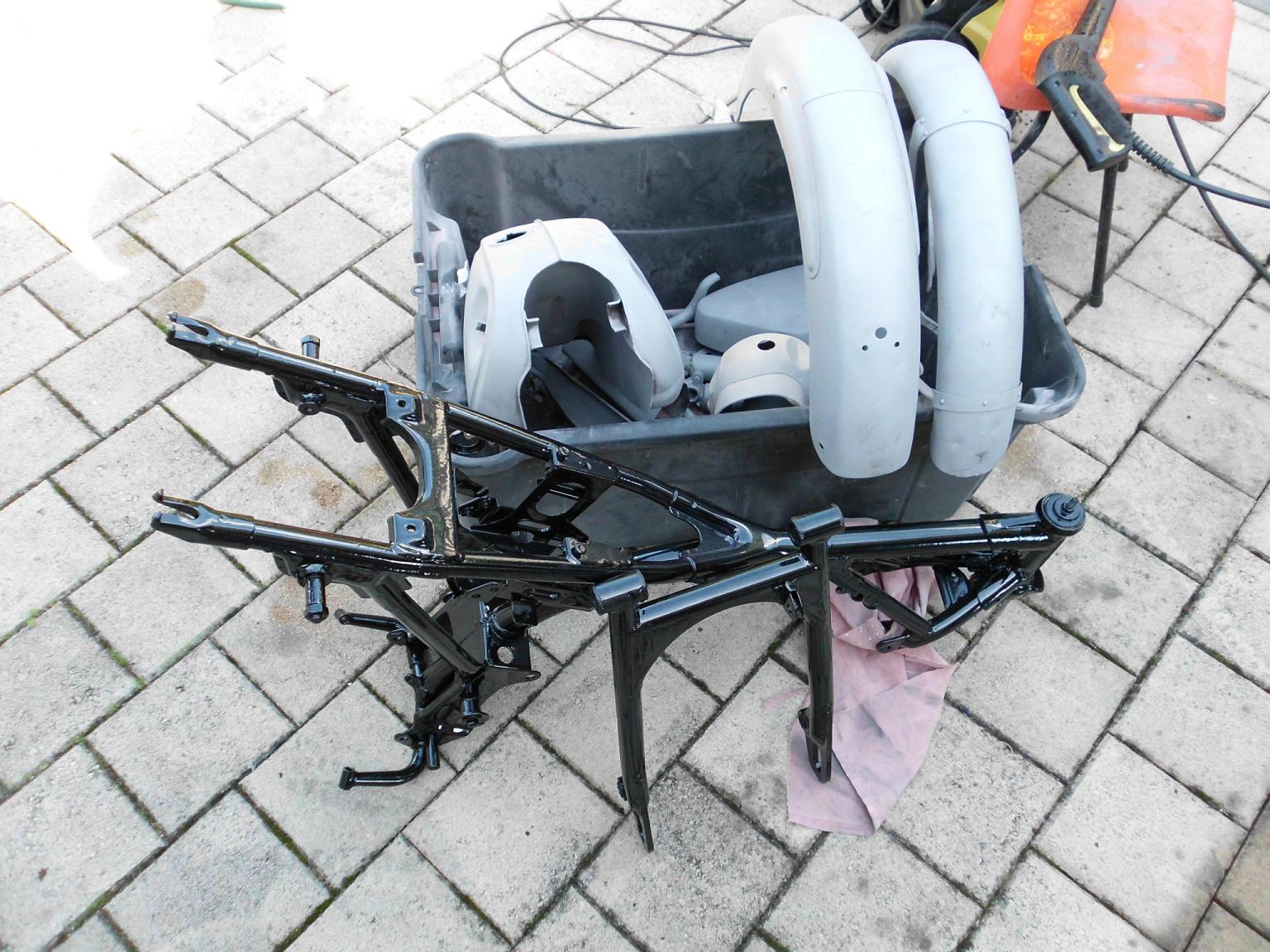

- After much deliberation I decided on powder coating of the frame and swing arm. The heavy build is not quite period looking but smart non the less. I managed to get the frame swing arm and addtional components blasted for a very competitive price. Note th
- Blasted and P coat resize.JPG (260.26 KiB) Viewed 2194 times

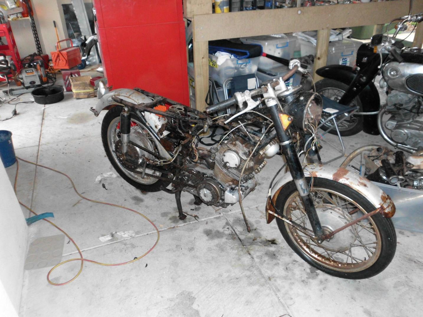

- Before photo, a bit of work ahead.
- before resize.JPG (223.75 KiB) Viewed 2194 times

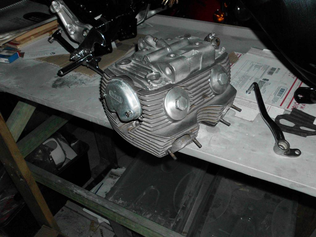

I spent a lot of time messing with the head. Fitted new cam bearings. Interestingly the exhaust lobes had approx 2mm extra lift so I wanted to reuse this cam for potentially a bit extra performance perhaps. I struggled getting the cam together as the splines are a larger diameter. After a few failed attempts at installing I returned to the assortment of cam components to find the matching cam sprocket assembly.
- head resize.JPG (103.94 KiB) Viewed 2190 times

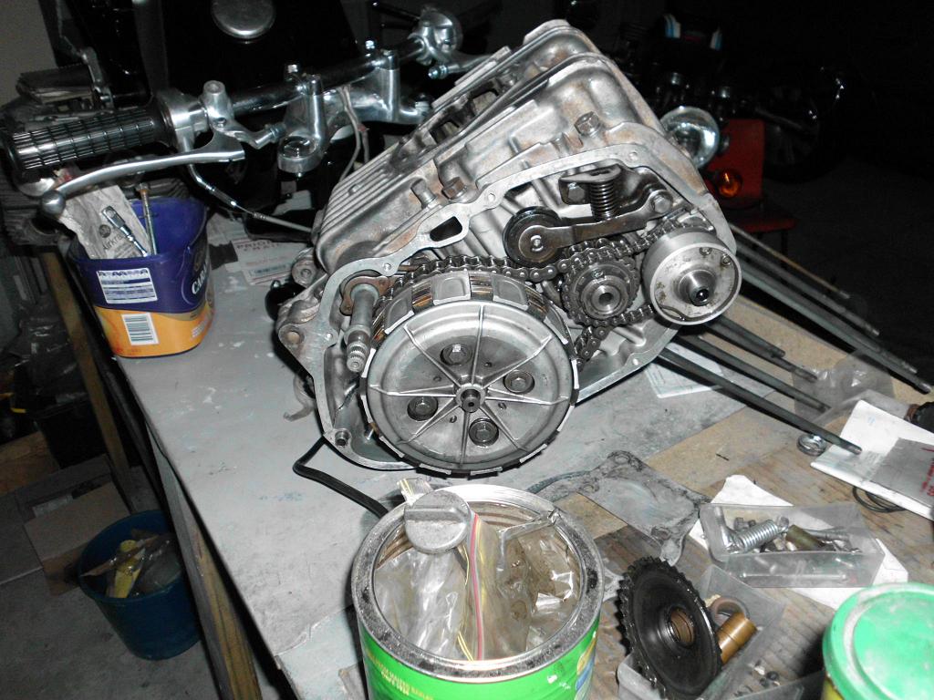

- I have managed to get the lower case together. I fitted the kick start shaft bush supplied by Tim at classic honda restorations as well as new cotter / shims. The end float feels snug but smooth. I was happy with condition of the gears and dogs.
- lower case resize.JPG (135.96 KiB) Viewed 2190 times

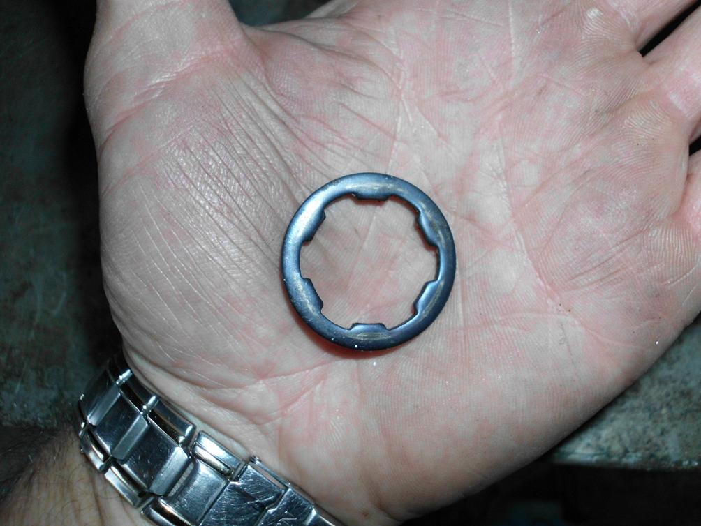

- Still havent found a home for this spacer, I cannot find it in the parts or clymer manual . Any ideas? Hopefully not internal but not a big effort to split the cases at this stage
- Spacer.JPG (95.9 KiB) Viewed 2190 times

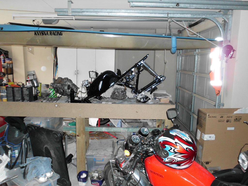

A bit of a progress photo.
Sitting the freshly painted tank on My first foray into the use of 2 part paint having previously been happy with Acrylic. Definitely more challenging to use but the depth of gloss off the gun is great.
Waiting on fork seals to arrived so I can get the front end built. Have fitted the chrome rear shock that were sitting in a box. I have the original back shroud units which I can fit once cleaned.
New bars and polished controls.
The motor was pretty tired. The barrels were very worn and the top ring almost non existent with the large lip o the barrel. 4th over pistons are now with the machine shop for boring.
- progress1 resize.JPG (131.39 KiB) Viewed 2188 times

I don't recognise the splined washer in your picture but there are only a couple of places where it might fit. Maybe someone tried to take up end float in the gearbox?

re the spacer. I have found several amongst the nuts and bolts of a few bikes , one I found appears to be bronze. I dont believe they are an internal shim on the primary transmission shaft due to a thickness of 3mm. The end float measures 0.8mm. I tried to be clever and had my father who has a decent lathe machine a few different thickness shims for the right hand side of the shaft behind the bearing with a view to reduce end float. Unfortunately while we were machining I realised that the clutch basket may pull up this slack and it did, pushing the looseness to the output side. As the shims were mild steel and not polished I chose not to butt up against the friction surface of the phos bronze of the 4th gear. Hopefully 0.8mm end float wont be too much of a concern.
The spacer could fit around the clutch shaft but there isn't enough play. My money is as a spacer between the oil slinger drive sprocket and the tang lock spacer on the crank end. perhaps the splined spacer adds additional friction to the sprocket?

HONDA didn't install that part in any of the C/CA/CB/CL72/77 engines. .......lm
