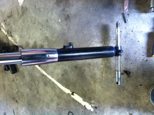

Should the piece directly below the seal and above the o ring be able to be removed? I have tried to knock it out, obviously through the non tapered end, but it is not budging. I am assuming it comes out because if I am to remove the fork seal by pulling on the fork upper, the seal is actually lifted out by this piece. It just seems to not be willing to budge. (I have removed the snap ring).
What I am asking is if I can apply force to the piece under the fork oil seal.

Post by versuspop » Sun May 18, 2014 9:24 am
This is the fork:
