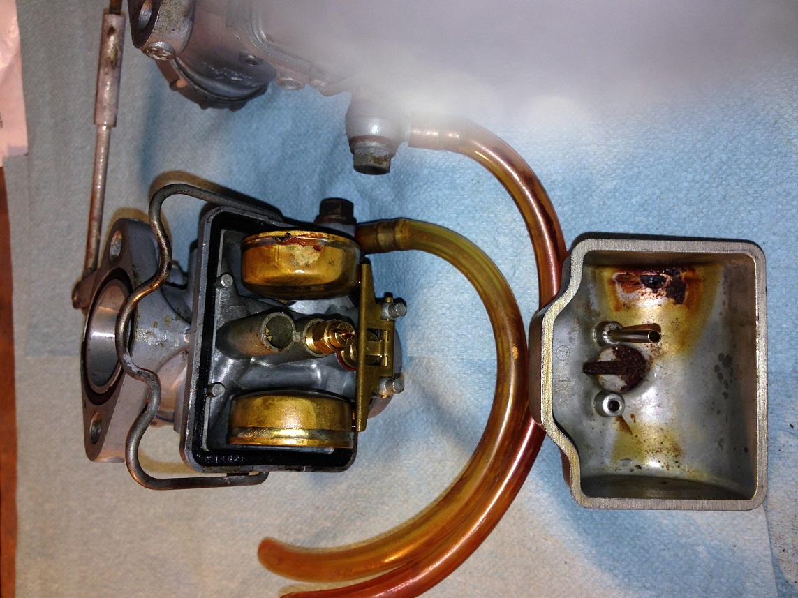

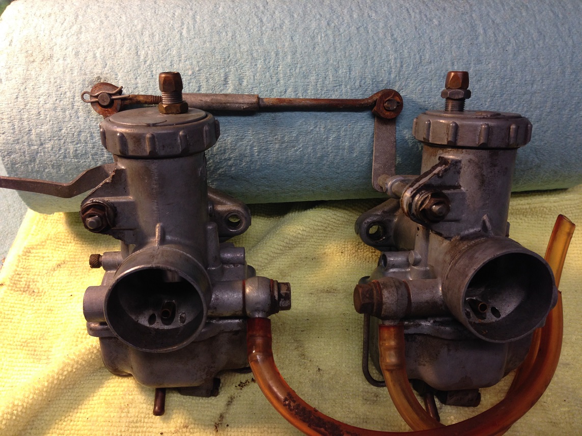

Carbs don't look too horrible. I should be able to clean these up.
