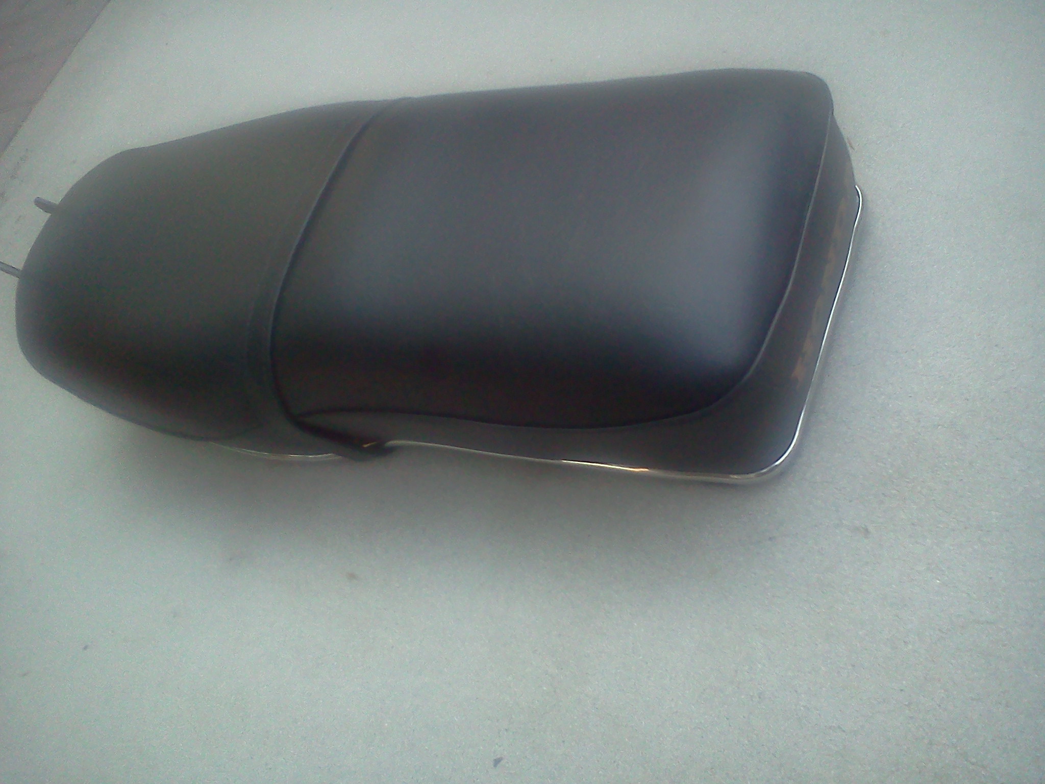

Post by russ » Mon Jul 14, 2014 2:35 pm
here is a link to pic of what I came up with as a final try for my Dream seat https://www.flickr.com/photos/112453054 ... 655124255/ https://www.flickr.com/photos/112453054 ... 468527278/ but I tried an idea of making it it bit of a chopper look , didn't work .
