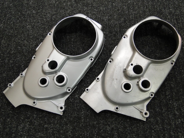

I use VHT SP127 "Universal Aluminum" on engine cases, covers, etc. Follow the instructions on the can which include baking at 200F for 20 minutes and it comes out fuel-proof. The pic is a cover I painted next to an NOS.

wow sorry for the late reply, but man that silver came out beautiful!!! So how did you fit your engine cases into the oven???!!!! :) Thanks for the reply!
