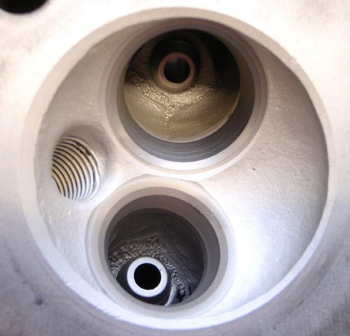

btw, this is how re-cutted valve seat's look like (not a CB77)

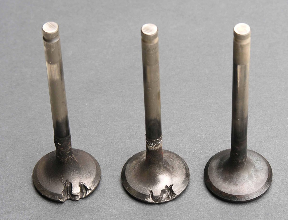

A pitted exhaust valve leads to glowing / burning around the pitted area. In the picture below you see the results of that. Another thing is that the heat won't be transferred to the sealing area, leading to heat build up in the valve stem, destroying your valve stem and valve guide. All just a matter of time.
